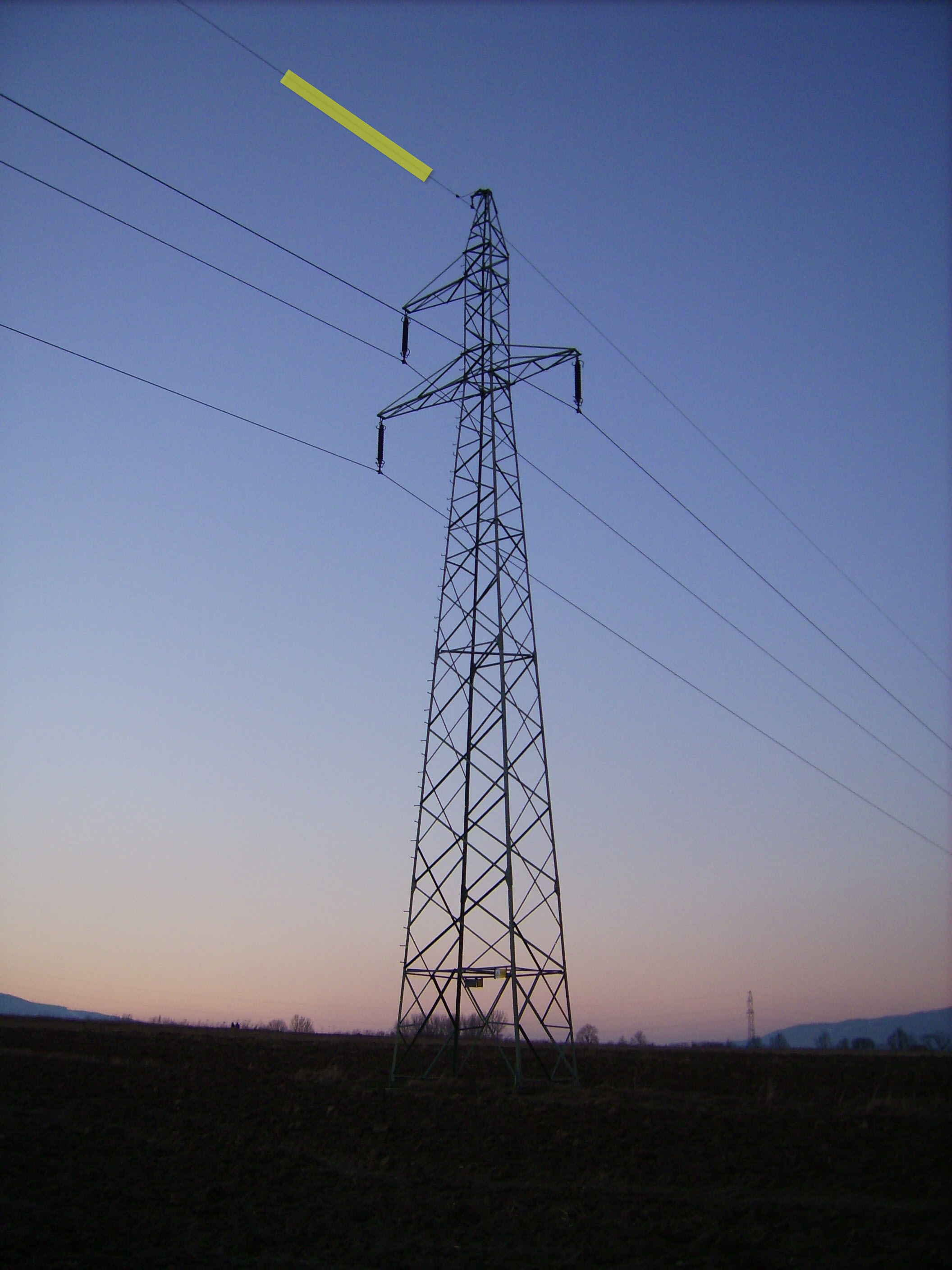

Hi
Please have a look here. I understand that ground conductor (in yellow highlight) is there to protect phase conductors from direct lightning strike. But I have noticed that sometimes brown/red spherical ball-type structures are also mounted on that ground conductors at fixed intervals over a certain length. Previously, I had thought that they use these ball-like structures where an airport is located nearby but recently I have found that these structures were used in an area which had no airport in its vicinity. Could you please guide me with it?
Regards
PG
Reference:

Might be for crop-dusters flying nearby.
Only a thought, but I have the idea that the "balls" may be to make the lines visible to large birds. By large I mean something the size of a goose or a swan.

These are usually placed where fixed-wing and helicopters are likely to operate. I have two at the end of my private runway where a 40kV power line crosses to make the line visible. I get to "land over a 50ft obstacle" every time we have winds from the east. Ours is not a public use runway, so the balls are there only because the power company is aware of our low-use runway.
I also see these out in the country where there is no runway, but there is a natural gas or oil pipeline crossing under a power line. The pipeline companies use fixed-wing or helicopters to periodically patrol their pipeline rights-of-way. The balls are placed directly above where the pipeline is buried.

Believe it. Very common in the Colorado Rockies, and has nothing to do with birds. De Plane De Plane

Not where I live. The top wire is there to catch the lightning bolts...

The top wire here is connected to ground at almost every pole.

Common with cropdusters. Besides, he wouldn't hit the ground wire, which is on top.

AERIAL MARKER SPHERES
(AVIATION BALLS)
Aerial marker spheres (or aviation balls) were
one of the earliest devices used in an attempt
to reduce bird collisions (Figure 6.8 and Figure
6.9). Originally they were used to warn
aircraft pilots of power lines. These large,
colored balls are usually attached to distribution
phase conductors or transmission shield
wires. They are available in a variety of diameters:
23 cm (9 in) to 137 cm (54 in). The
most often used sizes for line marking are
23 cm (9 in) and 30.5 cm (12 in).
Aerial marker spheres are available in a
variety of colors, including international
orange, gloss white, or gloss yellow.
So although the balls were originally intended to prevent aircraft collisions, they have also been used with a modicum of success to prevent bird collisions.
