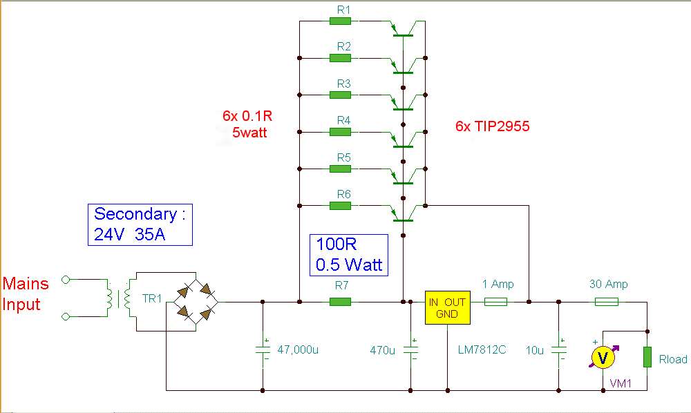

why dont you try this one.....replace the fixed regulator with an LM317T and you will have an adjustable supply at 30 amps...make sure you use a large heatsink,plenty of heatsink compound and a fan would also help as well.
regards mike
