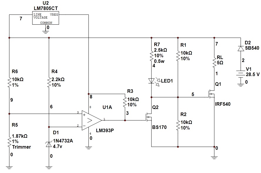

In one of my project I want to implement an Over Voltage + Over Current protection.
For Over Current I figured i'll just use a CB.
The Over Voltage I designed this way:
Source voltage goes into a voltage divider (2 resistors) and enters a comparator.
The second comparator input goes to a voltage reference (a zener diode).
The comparator output drives an npn transistor which drives the gate of a power mosfet.
The power mosfet is what switching the whole load which i want to protect to the ground or vcc (NMOS or PMOS).
I though of using a battery to power the comparator and zener, or perhaps use a 7805 to get 5v out of my power source. since the current used by the protection circuit is low I'd assume the 7805 won't need a heatsink.
How is the design ?
Is there a better way of doing it ?
Thanks in advance, Mike.
Seems like it should work. I think a voltage reference or a zener would be fine.
Post the circuit if you can.
It's more common to use a 'crowbar' circuit, as it's more or less 'fail safe' - doing it that way is 'fail dangerous'.

Semiconductor devices most commonly fail S/C - a crowbar thus fails in a completely safe mode, the other way fails and places high voltage on the supposedly protected circuit.

You might not like it, but it's the safest method, and is used commercially for that very reason.
Nothing is 100%, but a crowbar is a FAR hgher percentage than the other method.

Anyways, i designed something like this:
I wonder if the FET's (Q2) placement is problematic at all, since it would have a low Vds(on) would it somehow drive the other fet (Q1) into active zone or something unpredictable ?
Should I also place a cap across R5 to stabilize the voltage a bit ?

Crowbars are commonly used with CB's, one of the big advantages of crowbars is that it instantly protects the circuit as it shorts the incoming supply.
Crowbar circuit for over voltage & over current has been in use in TVs for years & work very well. In TV circuits they use an SCR to either blow a fuse or over load a SMPS to shut it down.
