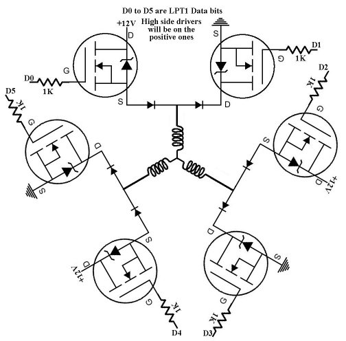

I am trying to drive 0.2 ohm motor coils with 12 volts AC and no more than 10 amps. Ohms law says that would be 60 amps. (But not for very long) I am making the AC under computer control and just swapping polarity. That part is working fine except that I need a logic level component on the positive side of the 12 volts. I tried the logic level IRL3103 mosfets that are good for 64 amps and 30 volts. With a resistor in line to keep the amps down, they worked fine on the ground side but the ones on the positive side blew right away. I know they weren’t getting +5 v above their ground, oscillations also.
A P-channel, logic level, 60 amp mosfet would be perfect but there doesn’t seem to be any such animal in captivity. Is there another device that I can use? Maybe an SCR? Can I switch a voltage regulator on and off?

PMOSs are half as efficient as NMOSs so at those power levels with the power dissipation involved, it's really hard to find a PMOS because it would be so huge and expensive.
Try using an NMOS and a gate driver IC. It will allow you to switch a high-side MOSFET with an MCU signal.

Well you don't need to use Ohm's law here. You need to have enough current drive at Vgs=5v, not the thermal rating of the transistor, to ensure you can start the motor and with a healthy margin.
MOSFETs can be paralleled very effectively if need be.
Please clarify with a schematic. I am not even clear how you have a 0 to 5v control signal and are switching the low side of 12v with an NMOS and also on the high side of 12v with a PMOS. For example if you had a PIC sharing 12v ground, the PMOS is going to see Vgs of -7v to -12v which won't turn it off.
It depends on the inductance of the motor coils, the DC resistance may only be 0.2ohms but at AC the impedance it likely to be a lot higher.

I am driving this right from LPT1 data bits with 1K resistors for protection. The gate driver IC sounds perfect. Can you recommend one?
I was hoping AC the impedance might work in my favor but I am trying to run it like a stepper motor so turning slow, I think it would be resistive again. Would a pulsed current of the same polarity keep AC the impedance going?
I started to make a schematic but being a Virgo, it might take a while.
Search them up. Maybe one of these. You will need to know the gate voltage threshold required to switch the MOSFET. Make sure to search and read application note on Gate Driver ICs.
Just for the high-side NMOS (low-side NMOS driven directly by MCU pin)
Each IC drives one high-side NMOS and PMOS

I will have to research the current sensing resistor and IC and H-bridge. The object of this game is to create a fractional horse power stepper motor from a small 3 phase motor. I want to control machinery with it. The steppers that I have been playing with are too slow and have no balls. Anything bigger is cost prohibitive. I think the best way to describe it is like a 3 phase Bi-polar (tri-polar?) stepper motor. I did actually have it running for a minute or two but with a resistor in line, it was slow and weak. The scope pattern looked like a good design for a water slide, an oscillating down staircase. The mosfets blew when I gave it more amps but still under 10 amps. Even if it doesn’t perform as well as I hope, I am at least amusing myself.

Ah, I see. Okay, so it's that you are using AC in the signal processing sense that you are not driving the motors with a purely DC signal. You are pulsing a PWM from a DC source. Yeah, everything I said before can still apply.
EXCEPT you will have to IC-sense chip to convert the voltage read across the current resistor into a ground referenced voltage (in ALL cases regardless of whether you go low or high side current resistor) because the way your circuit is set up, the same current resistor will alternate between high-side and low-side depending on which MOSFETs are on. Also, your ADC will be destroyed if you connect it directly to measure the resistor voltage because it can't handle the negative voltage across the current resistor because the current can travel through the resistor in both directions (assuming you place the resistors in all three T-intersection, rather than than at each ground terminal...for symmetry sakes.

I will have to study that. Maybe I can put the current resistor on the main supply. It would only see pulsating DC.
