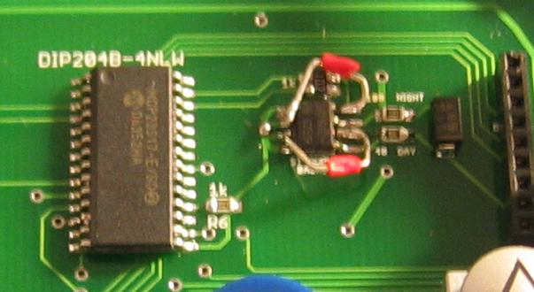

Yes you're right, I had the gates hooked up like an NMOS, reversed from what it should be for a PMOS. Thanks!
Let's find out how good my soldering skills are on cutting some traces and jumpering this SO-8 :)
That sucks. Maybe using a tiny carrier board to reroute the traces and then sticking that onto the main PCB- but that's just me. I just don't like to cut traces.
Naah it's OK, I managed.. I rotated the part 180*, bent some leads into the air and had at it with the iron. All better! I'm just glad it's a prototype and I don't have to do it another 50x :)
