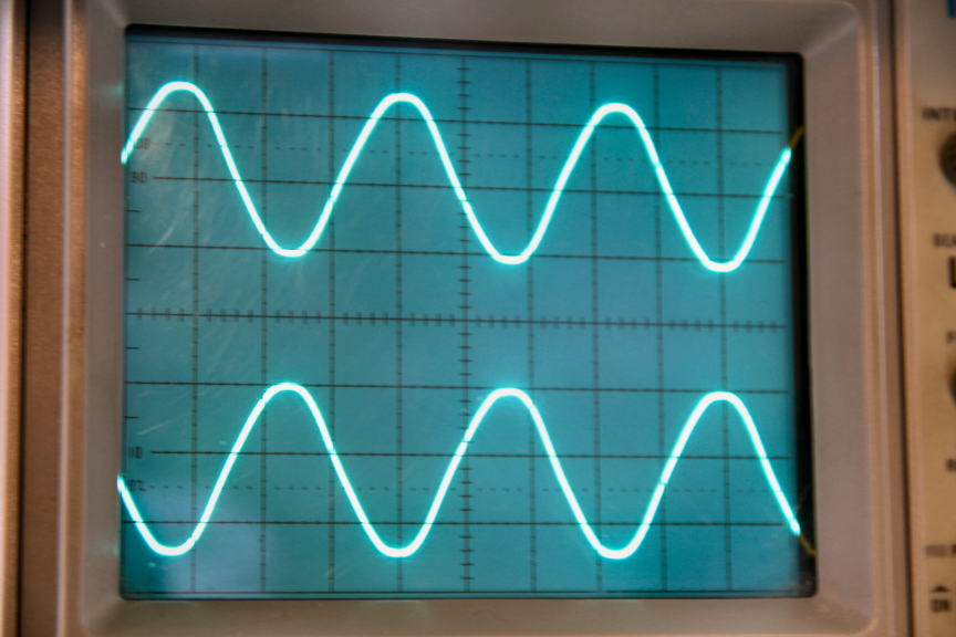

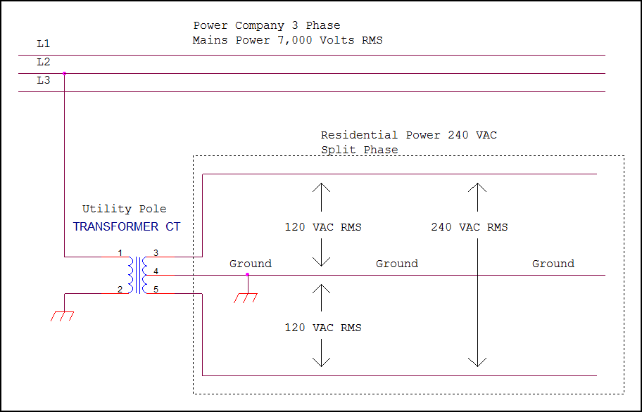

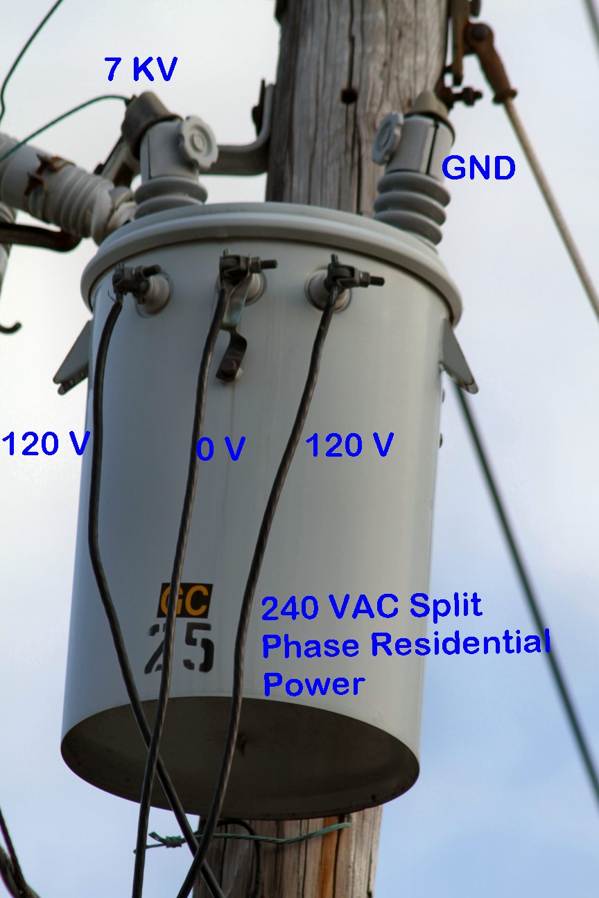

Maybe a few images will help things along. The first image is a mains power transformer pole mounted. This particular transformer feeds my house. Here the primary is single phase (one of three available) and about 7,000 VAC RMS 60 Hz. The second image is how it looks in a schematic. Here in the US mains power is delivered to most residences as 240 VAC RMS 60 Hz. split phase power. The third image is a picture of a scope screen illustrating the waveforms. Each channel has common to ground and the high sides to L1 and L2.
No, I did not use the 240 VAC mains, I used a little transformer to duplicate the one outside on the pole. In reality the waveforms are about 6.3 volts RMS. :) I managed to get bit this week by 480 volts so I am on a low voltage kick. The scope channels show the signals 180 degrees out of phase from each other, exactly as mains power enters a US residence.

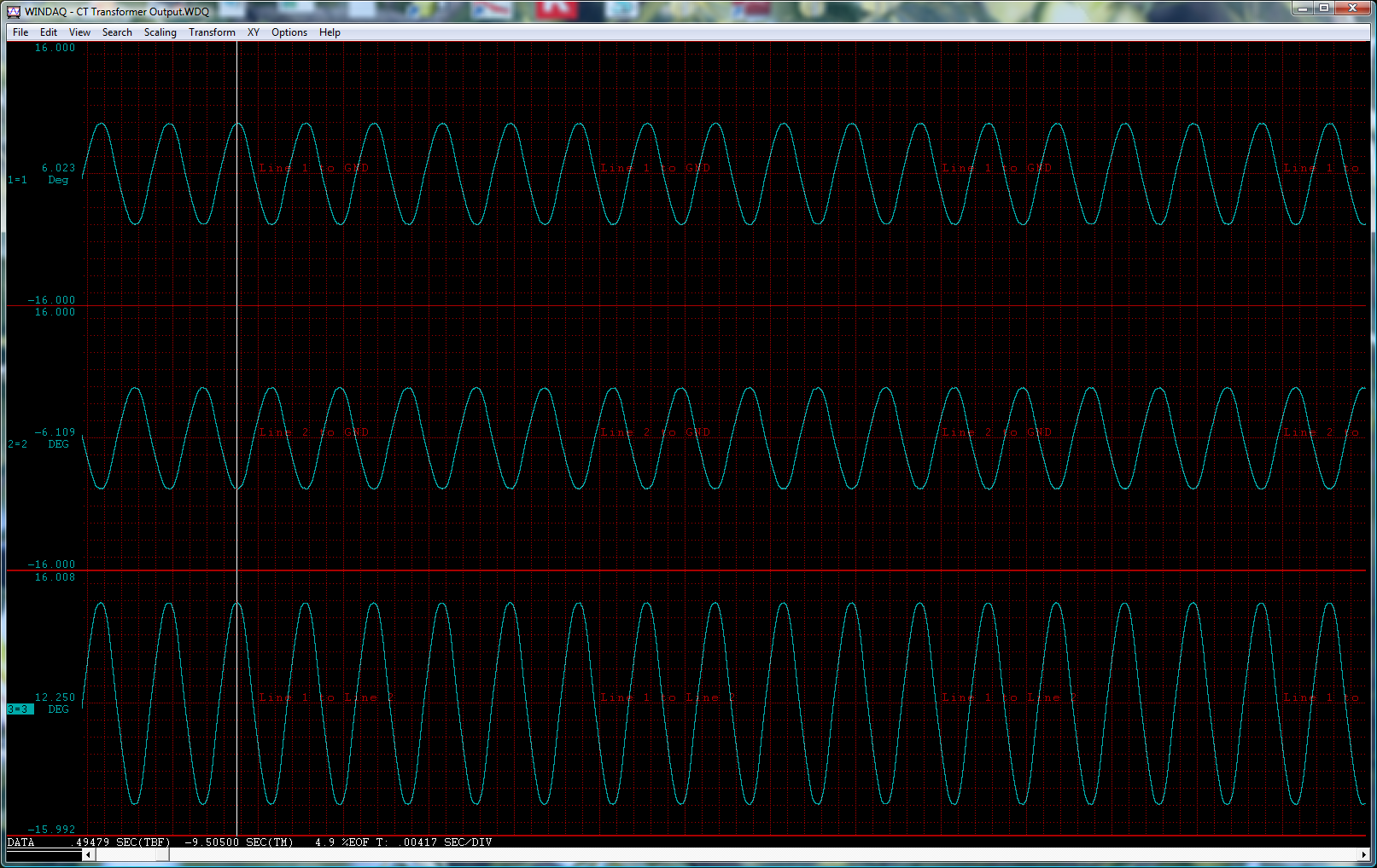

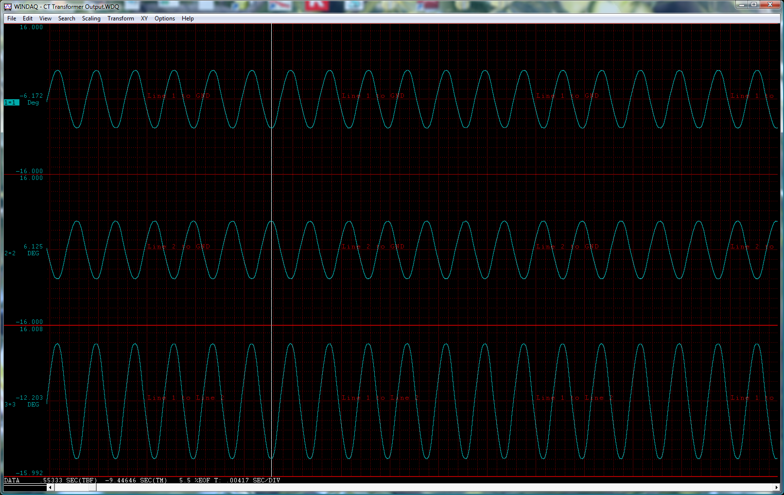

Anyway, in keeping with the thread, attached are a few more images that better show split phase. Channel 1 illustrates L1 to Ground, Channel 2 is L2 to Ground and Channel 3 is L1 to L2. The cursor in on various peaks and valleys. The voltages for the cursor locations are seen on the right. Triggering was on Channel 1 for the images. Additionally I used a data acquisition module with isolated differential inputs. This could not be done with a scope that shared common ground inputs.
Ron
