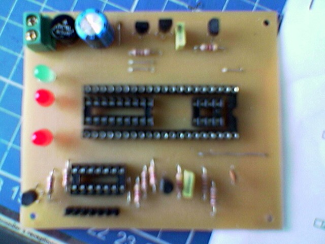

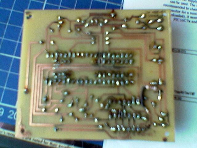

Hi there y'all. I'm a noob to pic programming and would really want your patience on this matter that I have regarding the p16pro programmer that I have built. There have been several conflicting schematics, as I've found out after etching and soldering all the components in, with the resister labelled as r11 (680r) / r9 (same value). My main thrust is to be able to build a digital clock using a seven segment led with alarm/date capabilities with the pic16f628a as its brains. In the pcb that I etched I noticed that there was no placement for the componenet r11, hence, as you can see from the image I soldered it from the backside of the pcb. Is my programmer ok based from the images I provided? Hoping for your kind and much needed input on this matter. Much obliged.

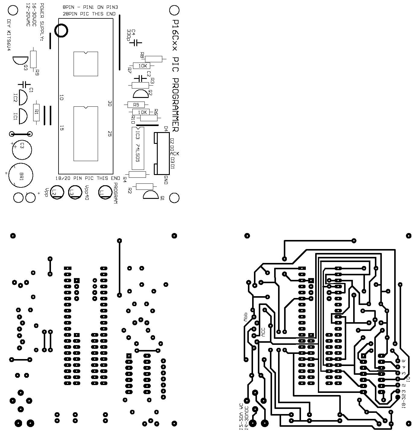

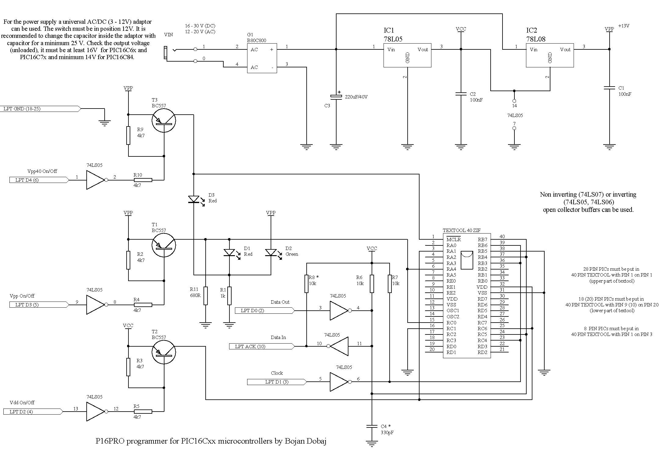

Sorry, but here is the schematic and pcb layout that has the r11 placement missing.

Good. I see your problem now.
The R11 is a resistor added after the PCB is built and people experienced difficulties in the PIC not entering the programming mode. R11 is just to pull down on the MCLR line before Vpp is applied.
You are perfectly OK to just solder it on the back of the PCB.
I would agree, although it's strange that there's a pull-down on the Vpp rail, and NOT the Vpp40 rail as well?.
I've never seen one without R11 on the board though?, so it must be a VERY! old PCB design - certainly the DIY Electronics board has it fitted correctly (between T1 and the Program LED).
