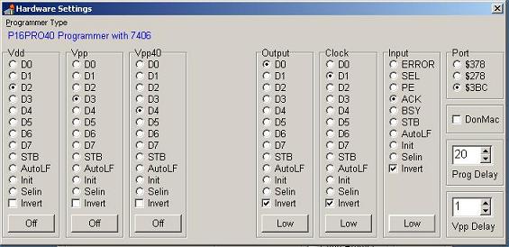

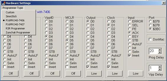

I am also having a weird issue with the WinPicProg software. When I go to the hardware setup (in both versions), it allows me to set each pin to high or low by clicking on the buttons at the bottom. If I go to Programmer Type and click on P16PRO40-7406, though, I can no longer click on the buttons. The buttons are there, but they don't do anything when I click them.
In addition, in the beta version, there is a setting for MCLR whenever I open up the hardware setup (even though P16PRO40-7406 is already selected). If I click on the programmer type again, that column disappears, and I can no longer click the buttons to set the pins high or low. That is probably a bit confusing, so let me know if I can clarify more. See the screenshots that I have attached.
Thanks!
