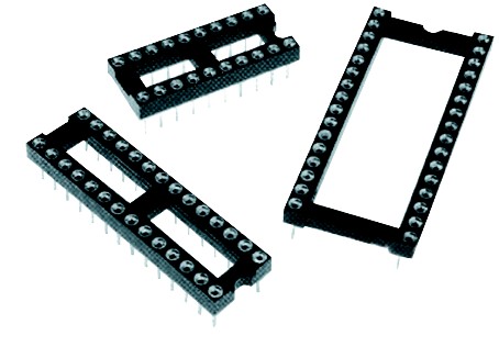

whats the difference btw turned pin socket as opposed to regular pin sockets?
A turned pin socket has round straight pins, this makes it plug-in to a normal socket VERY easily, and with hardly any chance of damage. I've been fitting them to my working PIC's for something like ten years, and never damaged either a PIC or a socket in that time. I've attached a picture below of turned pin sockets.
