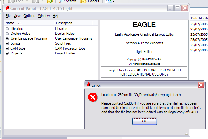

What version of Eagle are you using? will not open your file. See attached screenshot.

Re: eagle 4.11
4electros said:
i use eagle 4.11 and works well with me...
Ok. Is it the free Light Edition or did you buy a license?
If it's a commercial version, then make sure your Eagle license key is properly installed. In the Eagle Control Panel, click on Help, then Product Registration and enter the key you got when you purchased your legit version of Eagle 4.11

Re: eagle 4.11
Joel Rainville said:
It's free light edition and the CD that i installed the program with contains the program and license key file that enables me to run the program easily , i hadn't to register or buy a license anymore!!
