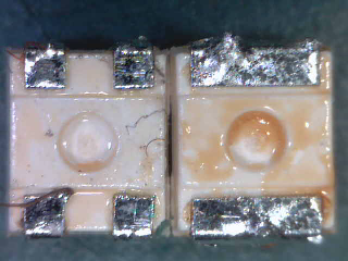

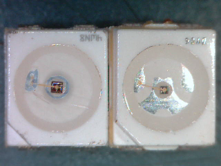

For single colour PLCC LEDs, the most common package seems to be PLCC-2, but for reasons unknown to me, I have also scavenged some single colour PLCC-4's.
In both attached images, the left LED is PLCC-4 and the right is PLCC-2. As you can see, they are both the same physical size and only have one die, but the -2 & -4 denotes the number of solder points. Why a single colour LED is available in a PLCC-4 package....I don't know, but I'm digressing. Maybe someone else can clarify.

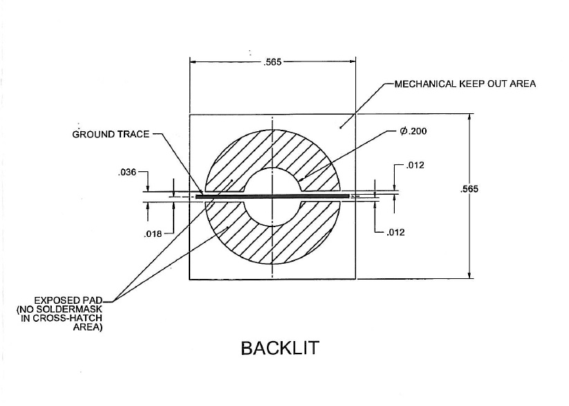

My application is for a capacitive touch switch. If you look at the attached file you will see the copper pads used on my boards and in the middle of the "donut" is where I currently install a T1 thru-hole LED. Basically a metal foil comes down and creates two caps in series resulting in less capacitance. This change in voltage is read by hardware and sent to an 8051. I use 3,000MCD, 30 degree angle, LEDs currently which provides enough light to shine up through the switch(it's clear) and hit the light pipe.
I'd like to have .010" clearance on each side to not short the leads of the LED and the capacitive copper pads. This is why I need such a tiny LED. I guess the better question for me to ask is what is the most common package tiny SMT LED?

We use T1 LED's for our currently backlit products which works perfectly. All it is doing is lighting up a keyboard key. So, the light comes up through the switch, goes through a light pipe and all the light hits a lazered plastic key. See the attachment. We have found after much research that the 3000 MCD @30 degree angle gives us the best splash on the keys given our mechanical set-up and dealing with silicone raincoats and all that junk in the way of the light.
Good Xbox example. Kinda made me want to go play some MW2 :) I'd agree on them being hard to handle manually. We are getting a SMT line soon so this design is my attempt to change all our technology over to SMT. The LED's are obviously just one wrinkle in this task. We are also modularizing everything which is where the real work is.
Ultimately I'm trying to find a common smt package, that is rougly the same price as our current T1 LED's which range from 10 cents a LED to about 30 cents for our blue ones. I'm replicating the data from our T1 LEDS(angle, MCD, etc) because they currently work great and serve as a good first order approx. of what I'm trying to achieve.
I'm leaning towards teh PLCC-4 or 2. I guess whichever I can get more readily and cheaper I'll go with. Thanks for your help.
