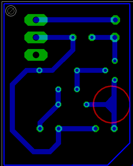

This is what i whipped up in Protel 99. All tracks are 25mil and a gaps are set to 15mil. I used polygon fill around the DIP and the power part of circuit to help with heatsinking as suggested by Audioguru. Look ok?
too many 90degree connections
the layout looks ok but get rid of all the T traces.
I usually just fill the corners with a filled 45 degree angle

90 degree junctions should look somewhat like that:
