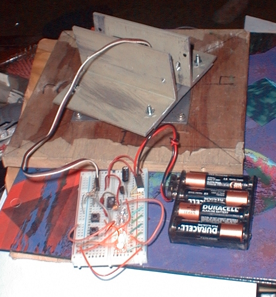

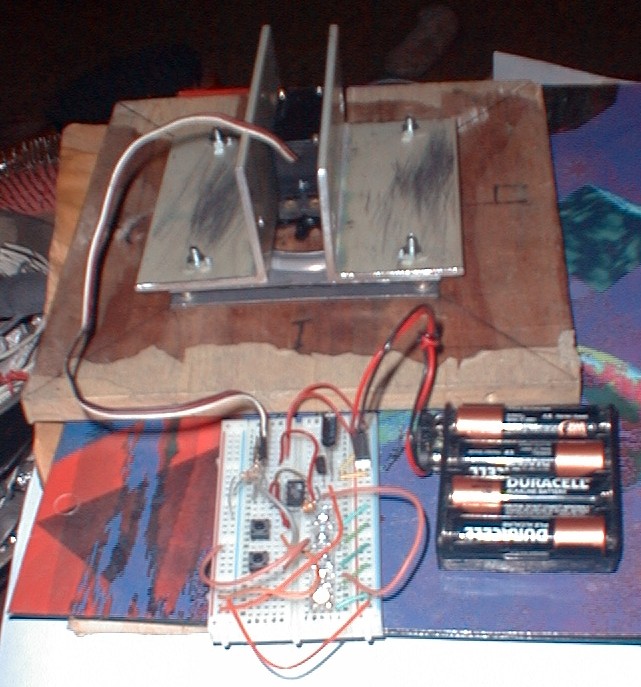

I've gotten quite a bit done lately on this airsoft project, and hope to have it ready to install after the holidays. Yeah, need to get busy on the christmas shopping and stuff. The swivel base is done, servo mounted, Tiny13 programmed, airsoft gun stripped down and re-assembled. Still haven't figured out how I'm going to mount it. I want to be able to adjust the elevation, or even later just add another servo for tilt. I've got the circuit on a breadboard, with push buttons and an LED, instead of the motion sensor and gun, works well. Need to shorten the arc, maybe see if I can smooth it out a little.

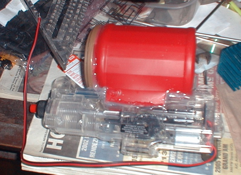

I'm planning on using a 5 volt relay to fire the gun. I pulls almost 2 amps at some points, figure a relay would be simpler then burning up semiconductors until I find something that can handle the abuse.
Will post some pictures tomorrow of what I've got so far.
