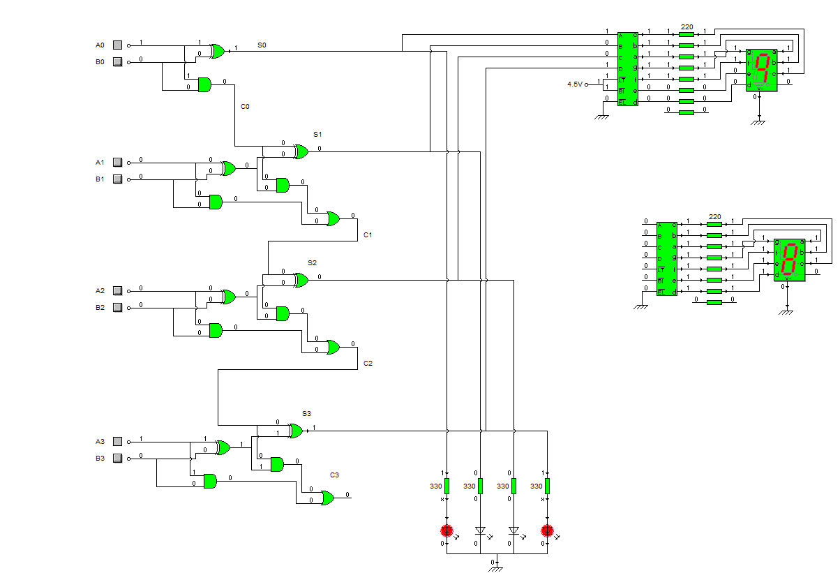

Hi. :) I'm trying to create a 4 by 4 binary adder in which the output gets converted from binary to decimal through a BCD (7447) decoder, and is shown on one dual-seven segment display. The part which I don't get is how to display the correct output on the "dual" seven seg, meaning showing the correct tens digit. I would be very thankful if you could help me out (I'm new to this stuff :cry: ).

I have attached my schematic. The part which I don't understand is for example when I add 8 + 1 + 1, how do I get "1" and "0" on the dual seven segment. :(
The BCD adder can only add to 9 so there is no need for the second digit. You need a two digit adder circuit. I don't know how to do that, but perhaps someone can tell you.
The alternative is to treat the adder as a binary adder then do a binary to BCD conversion.
