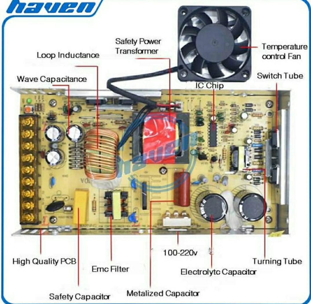

Well just power supplies in general i think, this i send you the image
