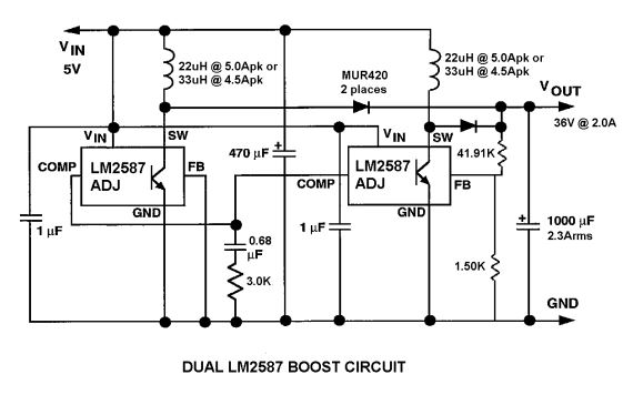

This TI note says we can parallel the LM2587.
https://www.ti.com/lit/an/snva552/snva552.pdf
![parallel-LM2587.JPG parallel-LM2587.JPG](https://www.electro-tech-online.com/data/attachments/104/104580-2b12338ede5f6a27646332806948e1f1.jpg)

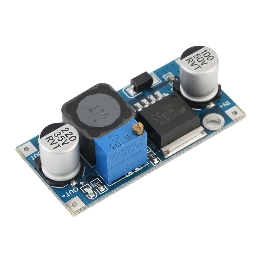

Is it safe and functional to parallel these off-the-shelf buck modules?
LM2596:
https://www.monolithicpower.com/pub/media/document/MP1584_r1.0.pdf
![LM2596.jpg LM2596.jpg](https://www.electro-tech-online.com/data/attachments/104/104581-67bab8c2d8ca09607e1e59e2dcc4db4d.jpg)

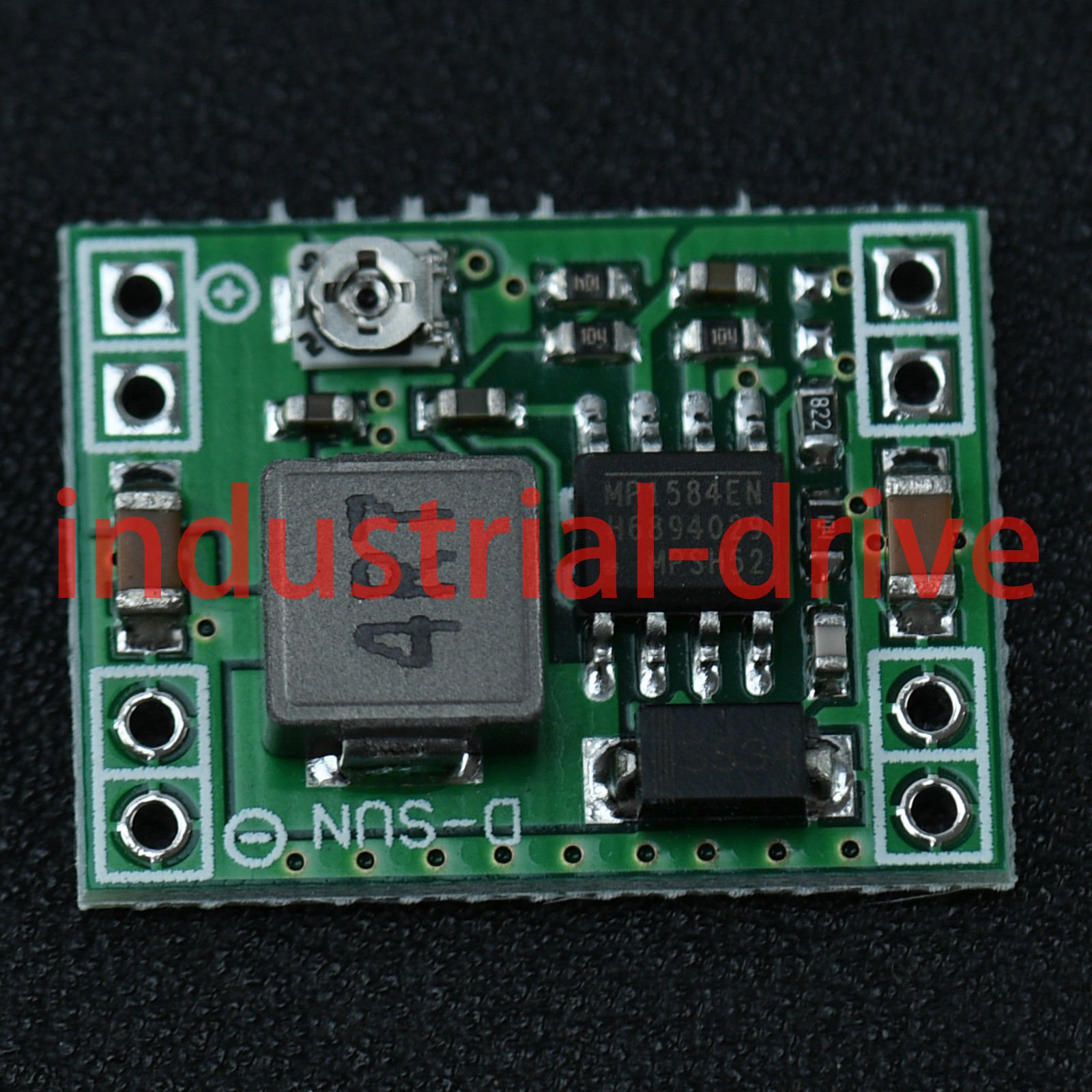

MP1584:
![LM1584.jpg LM1584.jpg](https://www.electro-tech-online.com/data/attachments/104/104582-a05d5c1c4060d40ec73e5793214f7c28.jpg)
i'm wondering, if their voltages are different, then the higher V will try to dump it's extra into the outputs of the lower V, which seems bad. Maybe could prevent with diodes?
