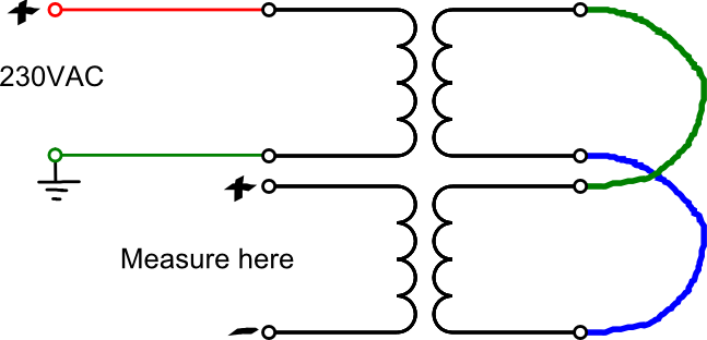

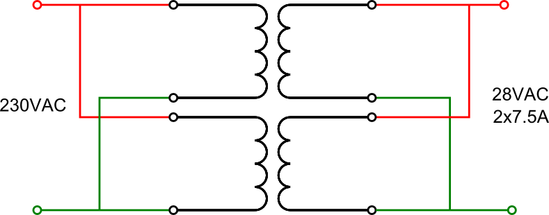

Just to be sure (it very important to avoid something bad happening). I set up the circuit on the figure and measure the output from the primary winding on the second transformer. If the polarity is as shown, I can connect the positive and the negative/ground terminals together.

It's safer if you do the measurement at the secondary as I stated.
You can not measure polarity of a single AC output as shown. The + and - indications on a transformer technically indicate relative phase, (0 or 180 degrees) not polarity.

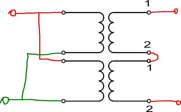

Now I think I read the text right. If I measure like shown in the figure, the phases will cancel each other to provide a 0 V and I can connect the '1's and '2's together.

Now you have it. If you measure zero AC volts (<1V) between the two outputs, then you can connect them together. If not reverse one of the transformer outputs or inputs.
If your final result is going to a bridge rectifier, it is safer (and may be more convenient) to put each winding into its own bridge and parallel the DC outputs.
