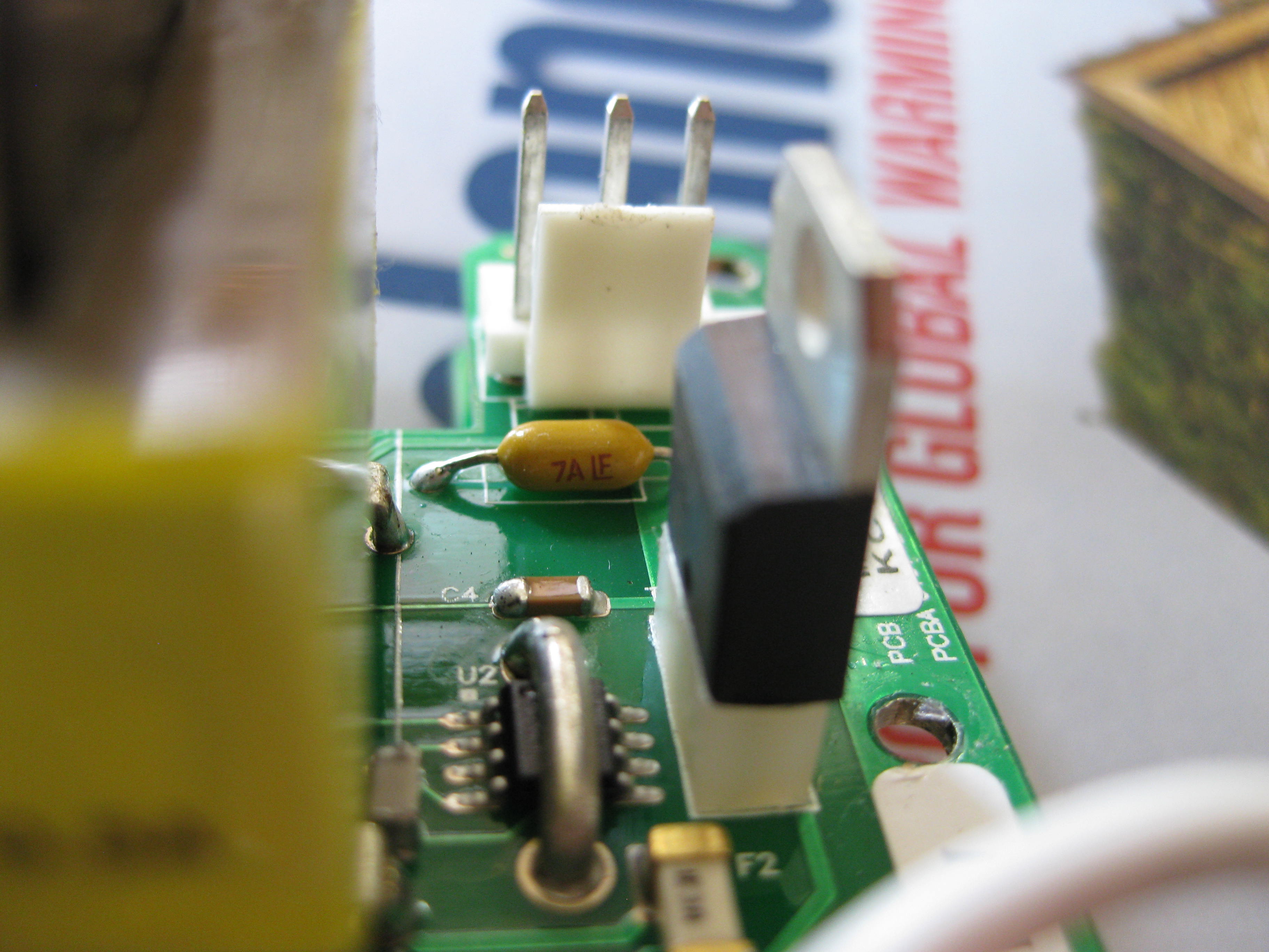

I would like help identifying this yellow part (7A Lf) that I think is defective in this switch. If anyone knows.
thank you

What's the silk screen marking say? It has a box around it, should have a label as well.
F1 makes senes for a fuse to me, 7amps?
Those three big honking pins behind it look like major power lines. Can't see the traces on the board though.
Something like this perhaps?
Thanks for the help, I think you guys are dead on. It just occured to me that this is one of the last components on the output circuit which would be protecting components upstream from overload. Why it blew with only 210 watts is my next project and why not replaceable.
