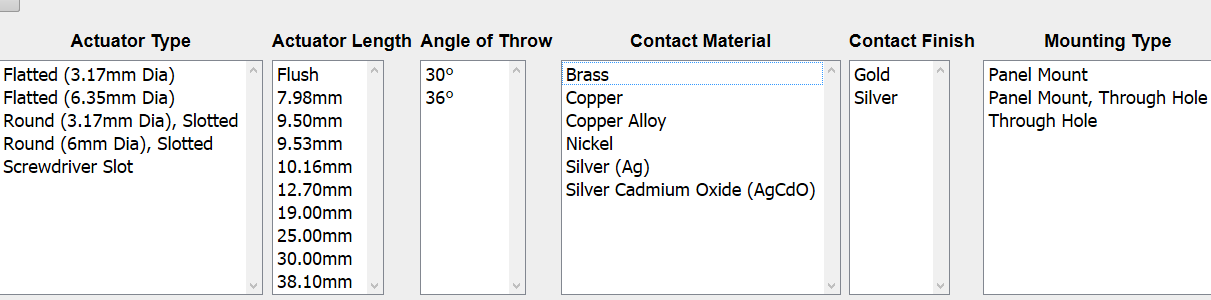

I bought some continuous rotary switches a while back from D-K where you can put a mechanical stop to use as many positions as you need. Standard 1/4" shaft thread-mount. See if that matches your size. ( probably too big)
BTW these come in both Silver and Gold plated contacts.... choose gold

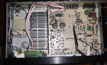

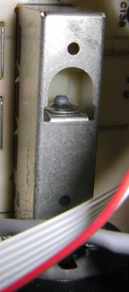

UHOH does this look cleanable?
anyone recognize a standard replaceable switch?
thanks guys

A straw on the can ought to squirt some crud in there ok.
If you use the same input all the time have you thought of just linking it out?
First impression is that the switch is a special that is screened for minimum hum and noise pick up. Can you see any way to remove the metal can around the switch to allow access to the contacts, or is the whole thing one piece?
spec
