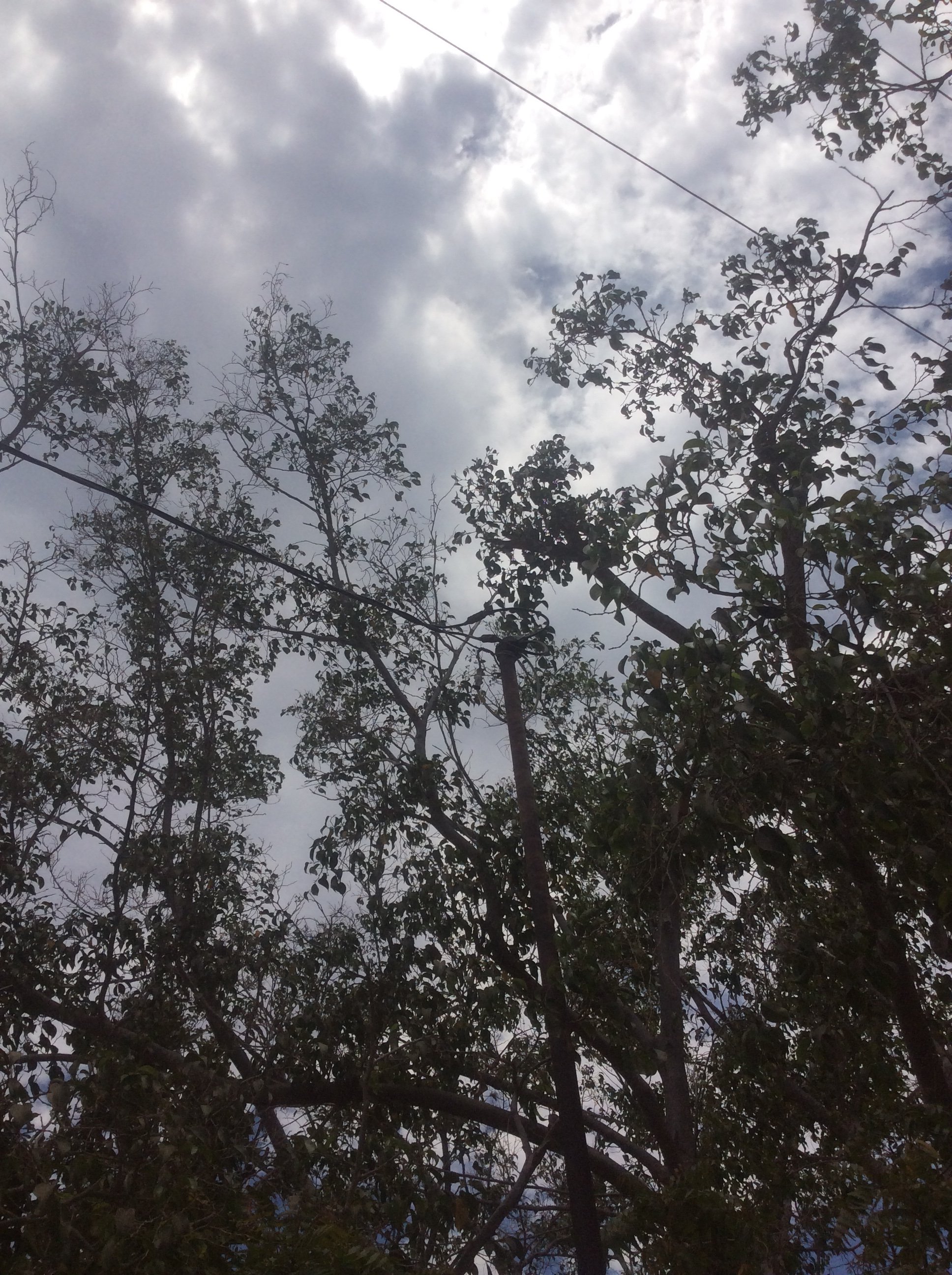

I turned on my kitchen lights,they flickered,buzzed,and went out,along with most of my house.....The three (40 amp) air conditioners are still running,and one wall socket works,and two ceiling lights....everything else is dead,and there are no flipped breakers....any ideas as to what caused this?
Aliens? Recheck the main utility line breaker(s). I've seen cases where one side of the NA split-phase trips when the other side remains closed.
Do you live a place where you have a neutral wire from the local power company?
Grossel-I see three wires coming in from the pole,so I interpret that as 2 hots and 1 ground....but,I am no electrician!
In the US and Canada and I believe North America in general that would be correct. Here in the US residential power is split phase 240 VAC with each hot to neutral being 120 VAC.
Before I married my wife she called me on night with a similar problem. Some of the residence worked and some did not. No breakers were tripped. I found one line from the power company, a hot, had rubbed enough on a pine tree it became weak and frayed till it burned in half. This caused the residence to lose 1/2 of its split phase 240 VAC. I have no idea how your power is distributed once it leaves the pole and enters the residence.

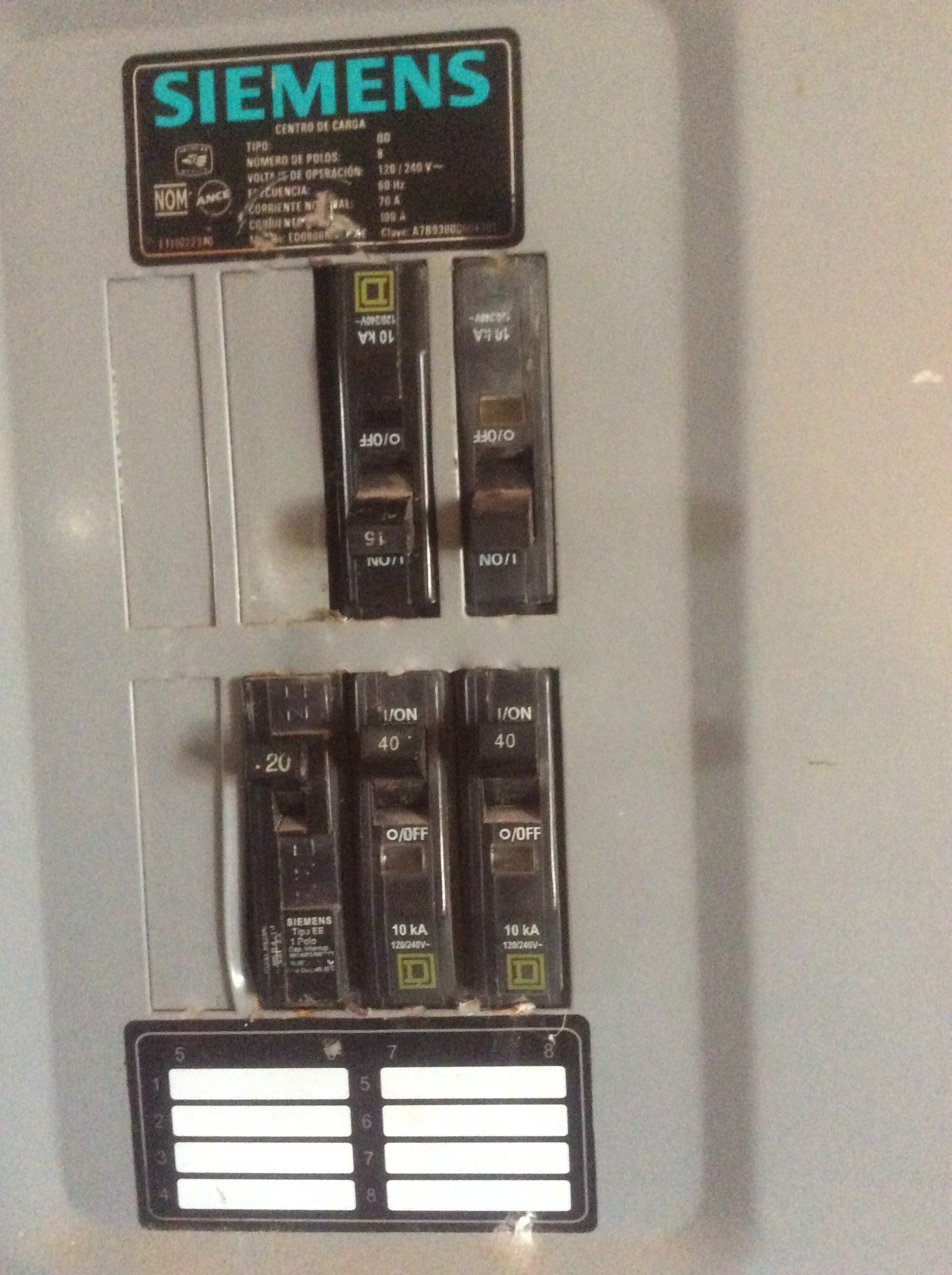

MaxHeadRoom78- The two 40 amp breakers control the air conditioners....there are two on one breaker,and one on the other

Those two 40 Amp breakers appear to be single pole, instead of 2-pole breakers (the handles are not connected.) That implies that the AC units are 120VAC units instead of 240VAC units that has been assumed. That said, it's unlikely that two adjacent positions in the breaker panel would be on the same leg. But not impossible.
So the possibility of an open leg from the utility may be back on the table.
Better to call your electrical utility.
That breaker panel appears to be a sub-panel, not the main panel.
sagor1-very good point!....I flip it on and off,but it never gets all the way back up......incredibly,this is the breaker that controls my last remaining 2 ceiling lights....they come on and off as I flip the breaker on and off......as I have said,it is hard for me to believe that this circuit only has 2 ceiling lights......my last remaining socket is on another breaker......hard to believe that this,too,is a complete circuit.
