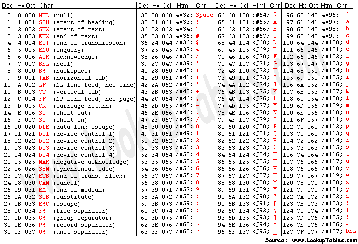

A useful tip might be to use the FSR/INDF Indirect Addressing to implement a stack for storing the password data. Whenever the PIC gets an ASCII value, you can set it up to store it in the first value you have set aside for a stack, and then increment FSR so it points to the next value. Whenever you get done parsing the sent text, you can just reset the value of FSR to the first value you used, and you don't really have to worry about clearing the values because they'll all have to be overwritten to initiate the parse function anyways, right?
thanks guys looks a bit over complicated to me. I have a ASCII table here i printed. It shows alot of info.
