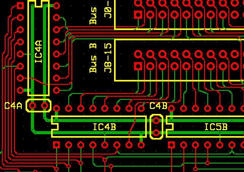

Maybe you can help me then. I drag a line from the pins that come up blue to each other how do I get the line to the pins when they want to cross each other? If they cross each other doesnt that mean they are now electricaly common?

When you place a component on the board, such as a dip16 connector, it is outlined in yellow. Yellow is the silkscreen layer color.
Red is used for the traces on the top of the board and green is used for traces on the bottom of the board..
To avoid overlapping traces on the same side of the board, simply select the layer color to use before placing a trace. If you want to connect an upper and lower trace together, select and place a "via hole" of the proper size, between an upper and lower trace.
For complex designs where your eyes may start playing tricks on you, you can temporarily hide any of the 3 colors by disabling its display using the buttons on the lower left of the panel.

So the way I get this design to work I m suppose to use both red and yellow traces one on each side of the board is ok and if i can not get to the other side of the board cause a yellow and a red trace are in my way i have to lay the parts differently?
Yellow is not a trace layer, but is used to signify a component outline on the silkscreen/solder mask layer. Red and green are used for actual conductor traces on the top or bottom of the board. Any red or green trace can cross a yellow silkscreen layer . Silkscreen layer is just a printed layer that is put on the solder mask after the actual board traces are manufactured, and is not even necessary or particulary desireable in a small prototype order.
Try to look it like a sandwich you made and placed in a plastic bag.
The bread slices would be the top and bottom trace layers, the meat would be the board itself, the bag would be the solder mask, and if you wrote on the bag indicating what was inside, that would be the silkscreen layer.

Here is a screenshot of a small portion of one of my layouts.
