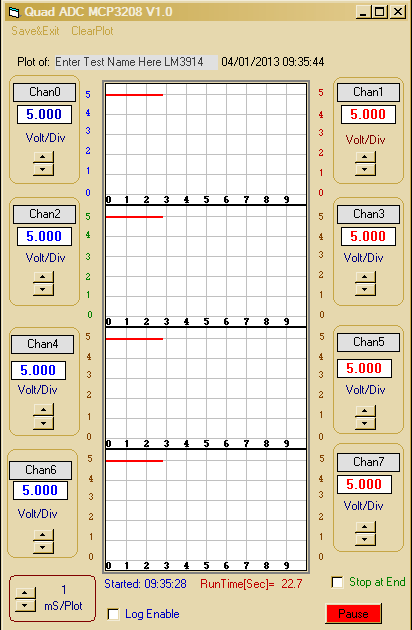

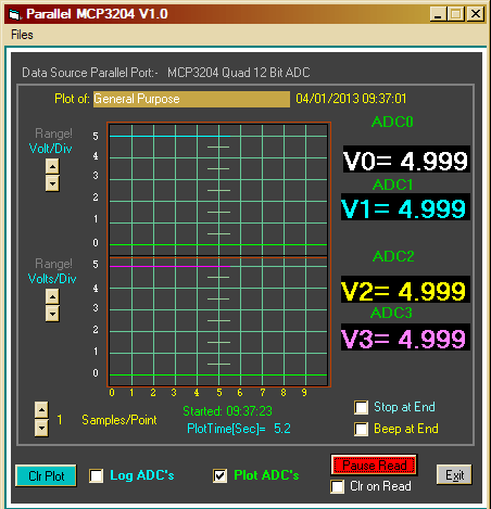

This is a method I used with VisBasic5, works OK.
In the zip are all the VB5 files for the 4 and 8 channel A2D MCP3204/8
[They are rough and not fully commented]
The circuit diagram shows the parallel port pins and OPA's.
E.
