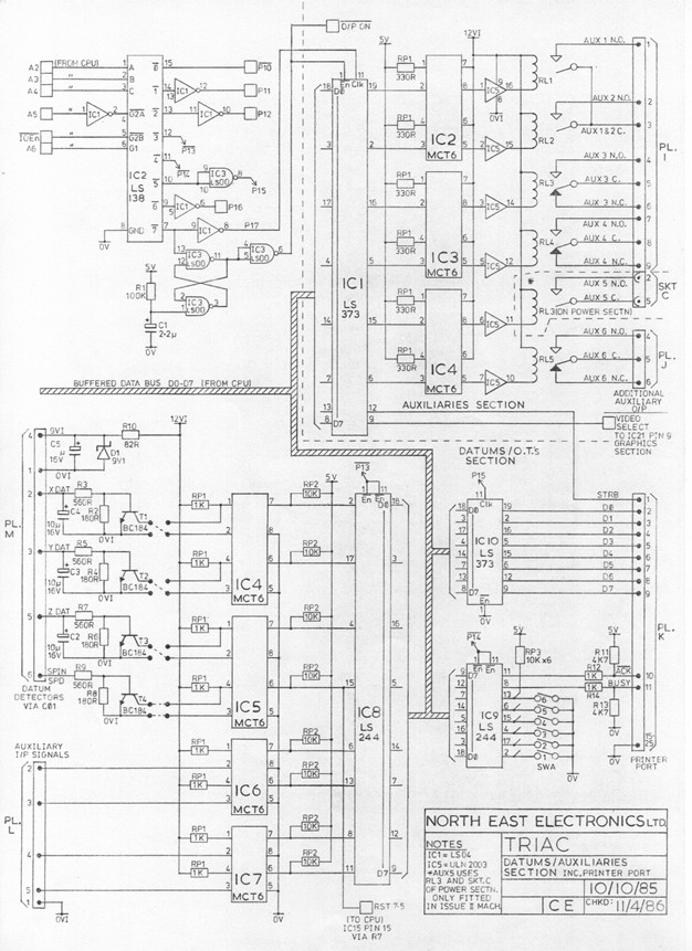

I am on with the conversion of an old Denford CNC milling machine from the 1980's electronics to be controlled by Mach3 from a PC.
Whilst all circuit boards can nowadays be bought off ebay to learn more about electronics I have decided to design
and build them myself. I have already done boards for step & direction of the axis and a board with 5-off relays to control stuff like coolant, spindle motor run, spindle direction etc.
I am now building a circuit board for homing datums, overtravels, and spindle speed monitoring with optoisolation to protect the PC.
It will have seperate X, Y, Z homing inputs but a single overtravel input daisy-chained around the 6-off mechanical switches.
See attached drawing of planned circuit.
CN1 = 24v taken from 250mA supply off one of my drive cards.
CN6 = 5v taken from PC parallel port
CN8 = loop to X++, X--, Y++, Y--, Z++, Z-- overtravels
CN2, CN3, & CN4 = X, Y, & Z home switches which are 2 wire type Baluff proximity switches
CN5 = Spindle speed monitor which is also 2 wire Baluff proximity switch
CN7 = Inputs to Mach3 via parallel port
Circuits for X, Y, & Z home, and spindle speed are copied from original Denford drawings but modified to accept my 24v supply.

Problem
When only the overtravel loop is connected, the osilloscope shows a very clean switching of input pin on CN7 (pin1) from 0v when in safe working area, and a good 5V when Overtravel switch is thrown.
When only Z home is connected, osilloscope shows switching of input on CN7 (pin2) from 0v whilst in 'working area' and a good 5v when the Proximity switch is triggered when homed.
When I connect both Z home and Overtravels (haven't built breadboard with Y & X homes yet), and monitor on 2 channels of oscilloscope, both traces show 0v whilst in the safe working area, but when I move the Z axis towards home I only get 1v when the proximity switch is triggered until I continue moving the Z axis to trigger the Overtravel at which point both traces hit 5v. Obviously 1v isn't enough to trigger an input to Mach3, so what have I done wrong or need to do to fix it?
