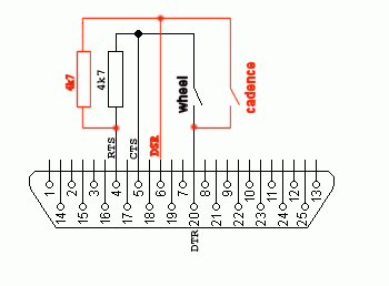

I'd like to connect a magnetic sensor (bicycle computer) directly to my computer through one of the ports without a power supply.
I found the attached circuit but don't know how to test it.
Can anyone make suggestions about circuit design - can I feed the wires directly into my parallel/serial port?
I'm also trying to write a program in VB6 to read the input, but not having much luck.
I'd really appreciate any help anyone could give me.
Pete

Yes you can connect these signals directly to a serial port, as long as these are the only connections to the switches.
You'll have to get the spec for a 9-pin serial port, since 25-pin serial ports have been rare since about 1989. Map the signal names on the diagram to the signal names on the 9-pin version.
