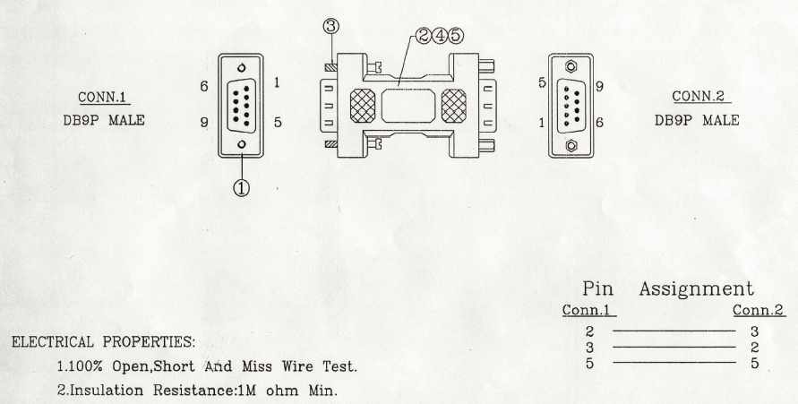

since this is inteligent device, it most likely will require crossover cable.
simplest crossover cable is just three wires like this:

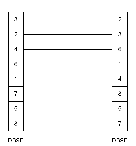

but if it requires handshaking, cable will be a bit more complicated, here is one common type that i use every day:
these things are standard and you should be able to buy them in any computer store for few dollars. user manual of your robot controller should include port specs including pinouts and recommended cable part number and/or connection diagram.
