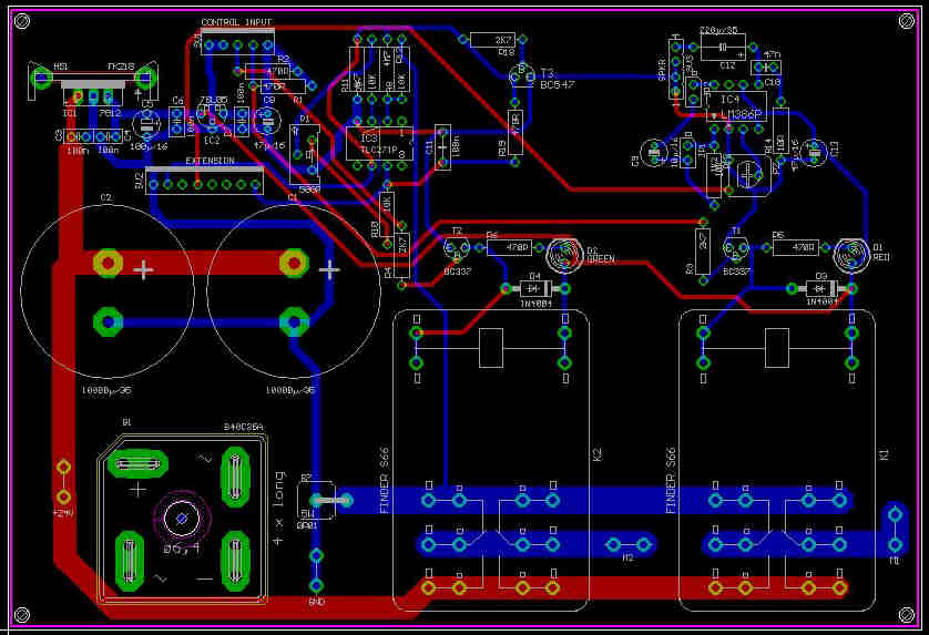

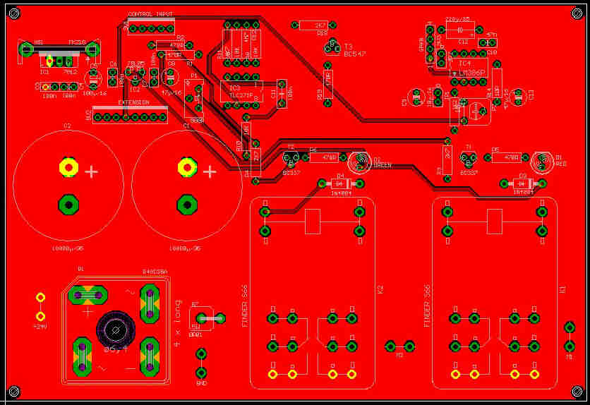

To avoid mentioned crosstalk you could make the entire empty space on the board both, supply voltage and ground layer. Addionally use decoupling capacitors spaced not more than 2 inches distributed over the board, mainly close to IC supply pins.

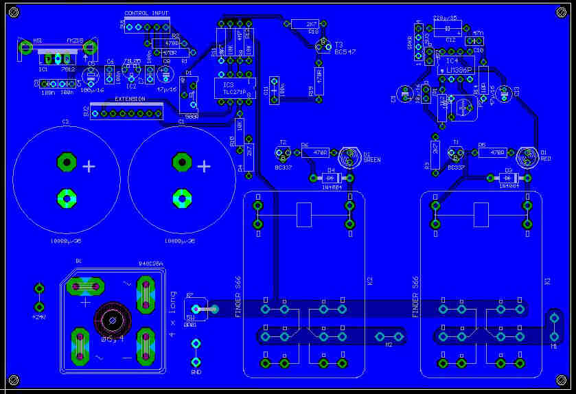

Here is an example of a 24V/35A PCB with relay outputs.
Picture1 shows the entire trace routing without using the empty space.
Picture2 shows the bottom layer used for ground entirely (except for signal traces)
Picture3 shows the top layer used for the positive output voltage.
Use the polygon and draw a rectangle around the PCB. Name the rectangle accordingly (ground for the bottom layer) and perform "ratsnest". All excessive board space will then be connected to ground.
Use the same method for the top layer.
It is also good for environmental considerations since less etchant solution will be necessary and less copper will dissolved in it.
