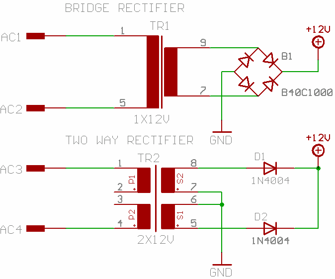

I am making a 12Vac to adjustable DC supply. The 120Vac to 12Vac transformer I have does not utilize a ground. The bridge rectifier, capacitors, and ouput all need a ground. What do I connect to this GND of the PCB? The ouput is DC and is variable 1.5V-12V, but it needs a GND. Should I connect these to earth ground out of a wall socket?

If you use a full bridge rectifier the -pin of the rectifier is the reference for circuit ground.
Don't connect any part of the low voltage supply to PE (protective earth).
Use circuit ground for the connected load only!
If you use two way rectification (2 rectifier diodes at the outer taps of the transformer) the center tap of the transformer will be circuit ground.
The sample circuit shows a secondary two coil transformer. Connecting both it is a center tapped transformer.
The center connection on the primary side is not drawn.

NO. Don't connect the DC ground (-) to chassis ground. Isolate it from the chassis ground entirely. This will make your power supply more versatile. ie: You'll be able to put it in series with another supply or use it as a negative voltage supply source.
By all means connect the AC ground lead to the metal case of the supply for safety reasons but float the DC - lead.
