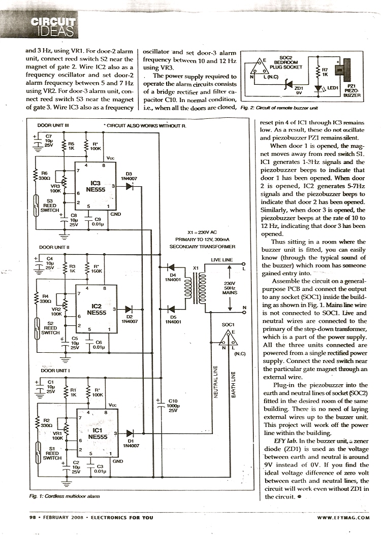

can anyone help me with the PCB layout of this circuit ( see attachement scan0005.jpg) ,, i have tried to make it with one of the cad software and made it also but the problem is that i have placed wires too close to each other and have taken wire thickness very less ,, so everything jst became confusing ,, i have attached that also View attachment My Layout1.zip ,, Pls can some one help me in this ,, I shall be really thankful ,, the circuit is quite simple for a experienced one ,,

It shouldn't be too difficult to make this PCB, But there is an Error on the schematic.
The Transformer Requires a Center Tapped output, going to ground. Either that or replace it with a 12 volt wall adapter.

Many of the software have facility to en-block increase the track width. But you did not indicate the software used. Instead of attaching a zipped .doc file , better attach the zipped files of the sch and PCB layout.

Its very easy for you that doesn't means it is easy for everyone ,, that circuit is simple i know but the problem i am facing is in NE555 Ics there pins shown in the circuit is not of the order 1234 5678 ,, then how to connect wires ,, they are intersecting at many points ,, and the no. of components is also more so everything is just soooo confusing ,, jut want something bigger and clearer
Then start with something more basic, a single 555 flashing an LED should be pretty straight forward. The 555 is the most popular IC ever made, you should be able to find lots of assembly tips with Google.

hey in that picture bredboard is used but i need to make that on PCB and i have studied 555 but how to connect it on PCB without letting the wires to get shorted ??,, can u tell me onething that the 555 ic i have bought from the market is NE555N so can u tell me the order of pin numbers because in Eagle layout editor professional NE555N pins are given as 2 4 5 1(top to bottom at left side of IC) 8 6 7 3 (bottom to top at right side of IC)

In the schematic capture they might be that way. You have to click the icon to make a board, then drag the parts on the board and auto-route it.
Make a single sided board and use jumpers if needed.

Don't ever make this circuit. It has many presumptions which are not realistic. for example,
1. thinking that neutral and earth are at the same potential. Imagine in case the power supply transformer is away from user building. the Phase and neutral leads will both have some drop of voltage. (may I call it voltage drop=IR loss). At huge currents, the voltage drop on neutral wire is itself sufficient to damage the diodes in series with output pins of the Timers, and eventually damage the 555 chips even.
2. As already pointed out, the secondary of the transformer should have been with centre tap and with connection to C1 -ve side.
The layout zip file attached is incidentally readable, being a .doc file.To be able to serve you , a member has to fully re-do the entire job, which i fear is not expected of us. Of course, you could seek clarification - on eagle how to increase the track width. Probably help file can clear your doubt.
I had no trouble with the zip file. I'm using Firefox 2.0.0.13, Winzip 11.1, and Word 2003.
Sarma is correct. It assumes that earth and neutral are independent. It also assumes there is no GFCI (RCD) on the circuit. And, if the line and neutral are incorrectly wired, it's likely to cause injury, fire, or death.

They are different in sense, the earth is a connection to ground at user premises, while neutral is grounded by the public mains distribution system at the distribution transformer.
