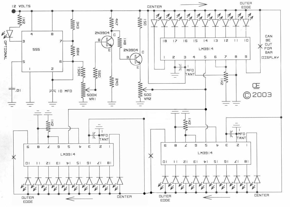

The attached schematic was quoted by PCB123 for $60 ea if I got only 2 of them. If I ordered 20...they were under $15. So it is all about quantity. For me, I only wanted a couple for testing, because I have no use for 20 if they don't work~! I have not tried anyone else yet. I also would be interested if anyone could do a couple for testing and be closer to $25 ea.

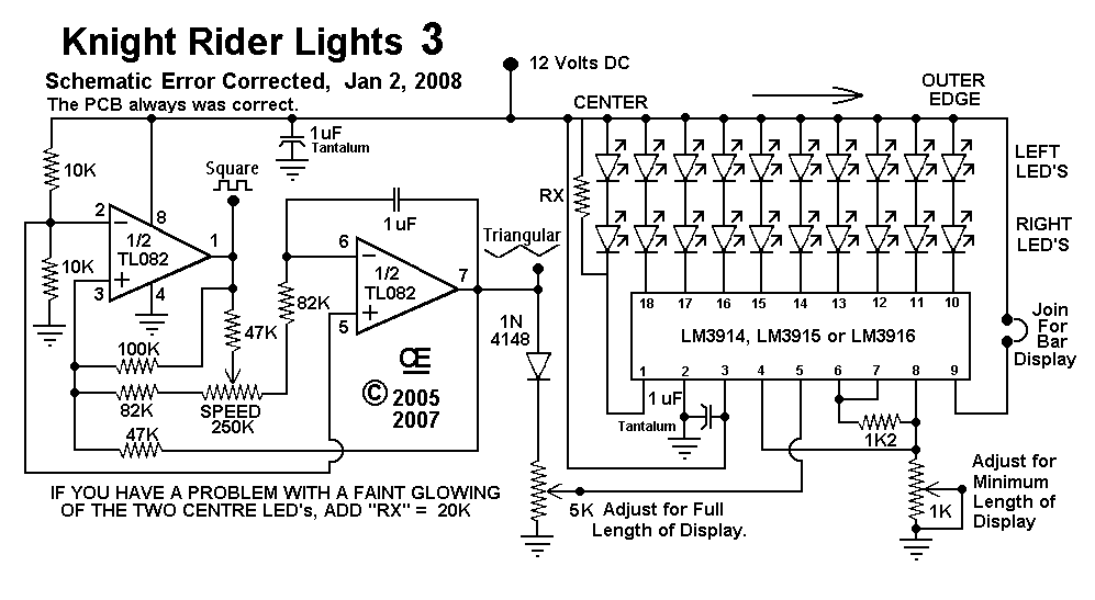

this is the schematic i am trying to make initially but it will be changed as i go along, but its not getting much bigger and cheap to me is like under $75 hopefully well under, keeping in mind that if is it a quality board i dont mind paying that much and i am looking at making my own but i want to determine how often ill probably need one to figure out which "kit" i should get. i was looking at a table top one that cost about $897 and i might end up getting it in the somewhat distant future.

What do you mean "kit?" Do you mean for etching? If that is what you mean, then that is way, WAY too much! My set up was under a hundred... not including the computer. (If that price includes a copy of EAGLE CAD, then it isn't bad.) :p
BTW the free version of EAGLE should work for you.
Have you bread-boarded your circuit to make sure it works as expected?
