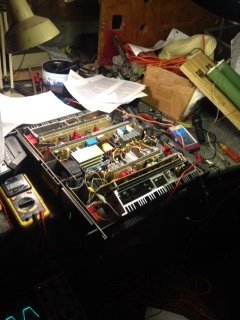

OK im new to this site...I would like some help if anyone wants to chime in,.I have fixed a few amps in my time but this is a monster...
Status...
it is a 600watt per channel stereo class d amp...A channel is working ...B tries to work but is distorted. Power supplys check out ok.If I disable the ddt (peaveys protection compression circuit)and test across dummy 8 ohm load I can see distorted positive sine...I recently read up on class d on how they pulse width modulate the signal with high freq square wave to drive the fets...getting access to put a probe on this is very difficult
Anybody have any personel exsperiance with these? I will continue on thru the fog and post updates periodicallly

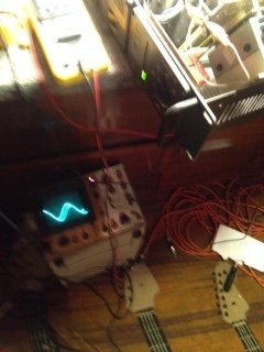

Firstly, can I ask what you mean by a "distorted positive sine"? Is that to say just the positive-going half of the sine wave, or a sine that is positive (in phase) with what you are feeding in? What kind of distortion are you seeing (perhaps a photo of your scope trace?).
With class D the most common failures stop the amplifier working completely (usually letting the smoke out in the process). If we're lucky here then you've got a fault on the input side, before the amp propper. Can you identify some input circuitry and try and probe the signal before it is fed into the modulator, see if it's clean there?

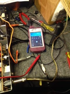

Tom I don't think that's old Peavey info..I don't thing they repair this one anymore. I can send you schematic if you want. I have DDT out of ckt so i can see distortion. I have been trying to trace analog before it gets to digital. See above top half of wave clipped...not at low input level though.Input at 30% looks clean on output...does that mean FETS working?
On the plus side, if you're getting output then we can be pretty sure that the output FETs (if they are FETs!) are working. On the other hand, faults where "it's working a bit" can sometimes be a lot harder to track down then "it's completely dead".
So you say you're getting clipping on the top half of the wave, as per your right-hand drawing, only on one channel and only above a certain output level? First things first, have you checked your power supplies. Measure the DC power rails on both the output stages (these should appear on the output devices and main PSU caps), and check to see if they are the same. Check low voltage power rails around op-amps and other ICs on the intput stage. It's also worth putting a 'scope on these rails and checking that they are free from ripple. It looks like this amp has a switching power suppy - is this right? Is there any sign of damage, overheating etc, and are any of the capacators bulging or showing signs of leakage?

That almost looks like deadtime distortion, but I imagine the modulator uses the same triangle gen for both channels. Hmm, yeah I agree with above, check all supplies with a meter and a scope.
