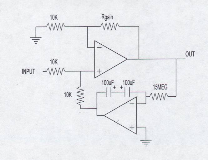

This circuit will maintain zero volts out within the range of the op amp, but signals above .001 hz will pass. You can follow it with a low pass to limit the bandwidth. The gain is (1+Rgain/10K)/2.
