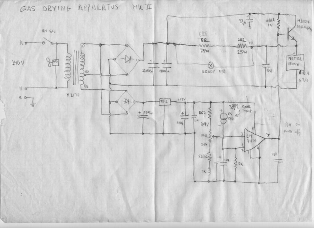

You will need very good insulation between the hot and cold side, there is some good info on the net about this - will try to dig up the URL later for you.
My circuit ( don't have access to a scannerhere) is basically a full bridge power supply, the peltier module being fed via a MJ1106 darlington transistor which in turn was controlled by a temperature sensor.
The darlington had a 8 ohm/25W resistor in parallel which fed the peltier on lower power during the off cycle, thus giving it a soft supply.
I remember tinkering with the resistor values for a while to get the device cycling slowly at the desired temperature, since the cold side was just an alu block 50x50x25mm with air ducts inside.

Hi Bryan,
Here is an old pecil scetch of that Peltier circuit I mentioned. It was drawn long before those nifty computer drawing programs became available.
have fun,
Klaus

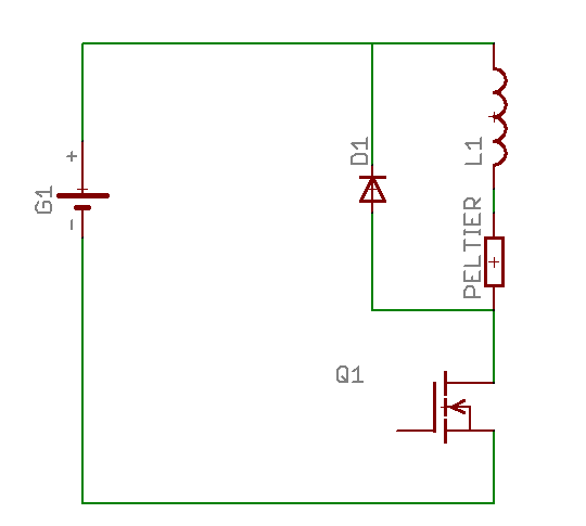

ppl have said that you should not PWM peltiers since they do not like being switched on and off very fast - I dont know much abt peltiers so cant comment
BUT if you were to connect in series with the peltier an inductor and in parallel with the L-peltier arrangement a diode (for free-wheel purposes) then you can PWM, that block happily and the peltier would not be switched ON and OFF
PWM really is the way to go

When the **** did I say CAPACITOR!!!! I said inductor in series with Peltier in parallel with that arranagement a diode to allow a freewheel path. That arrangement is then chopped via a MOSFET.
Bar the inclusion of the peltier, that is a standard chopper cct, one that I learnt in year-1 of Uni, after a 4years Masters and 5years in the Aerospace as a Motor-drive designer I do know abt PWM, fool
The point of the inductor is to "smooth" out the chopped current (if it is large enough the ripple will be low) such that the Peltier sees a constant-current source, the average value of it is controller via the PWM and a current controller.
Peltier blocks are current devices and need to be sourced current. Simple control a battery and a resistor, if you want more control then PWM in a current-source arrangement is needed
Have a look at the cct for what I ment and note NO CAPACITOR!!!!!!

I Previously Wrote:
Peltier devices work best at there Rated Voltage
I Should have written: "Peltier devices work best at there Rated Voltage And Current".
I Never said you used a Capacitor.
But in essence your inductor circuit will give the same Effect. Averaging the power, resulting in Reduced Power and poorer efficiency of the peltier device.
I also Never said you Can't control Peltier devices with PWM.
I said or at least ment to imply: that it is not an efficient way to go.

I can tell you exactly why on/off PWM is not recommended for Peltiers. If you try to run a 10v Peltier on a 15v supply switching on and off the overall losses- and resulting heating- go way up. Thus it is not only considerably less efficient, the overall pumping capacity is lower. So you're supposed to use a switching power supply to get 10v and preferrably as little ripple as possible.
There are many switching "buck" regulators which can do this. They are a bit more complicated than normal regs and require you to do some inductor selection. I would actually suggest a current mode PWM device like the HV9910. Technically it's designed for LEDs but it puts out a constant current regardless of input voltage so it should work ideally for a Peltier and it's simple to work with.
