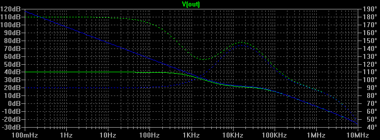

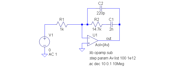

Read my previous post. Below are schematic and Bode plots wih Avol set to 100 and to 1e12.
Keep in mind that -270 degrees=90 degrees.

Ron_H, I am not sure what I am looking at in that bode plot are the dotted lines phase and the solid lines gain? And i'm assuming the blue line is the open loop gain set to 1e12 and the green line isn the open loop gain set to 100? Then yes it would seem your simulation shows the phase of -270 whent he open look gain is set high.
And yes when I turn the open loop gain up, I get a plot that looks like yours, except the frequency flat lines at 90 degrees again instead of going below 90.

Fusion, you are interpreting the plot correctly.
Your phase settles at 90 degrees because you are using an infinite (or at least very high) bandwidth amplifier. My amplifier model has a single internal pole with a gain-bandwidth product of 10MHz. The additional high-frequency phase shift is due to that pole.
A final (?) note of explanation: If you work out the transfer function of an operational integrator, the pole is actually at w=1/(k*R*C) (w in radians/sec), where k is the open loop gain of the op amp. You can see that the pole is at zero frequency only if k = ∞. As k goes down, the pole frequency goes up. You can see that on the Bode plots I posted.
