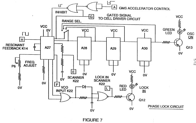

I'm Designing a PLL with cd4046 Ic to control a resonant transformer. I have a doubt at this point because i think there could be a delay or phase difference between the signal i'm applying on the transformer and the signal i'm getting on the feedback. So i would like to design a phase delay witch is independent of frequency. As the feedback signal is 50% square wave i know that i can have a 180° phase delay by using a not gate. But how can i have a 90° phase delay? Or 45°? Or it's possible to have a variable phase delay from 0° to 360° witch is independent of frequency? I'm working from 1Hz to 100kHz.
Where is the phase delay? The phase comparator in most PLLs puts the VCO in phase quadrature (90 degrees) with respect to the signal being locked to. Is that what you are talking about?
Thank you Mike for answering,
Yes it should at 90° with the 1° comparator and 0° with the second one. I want to find a way to delay the feedback line, because as there are many steps for it until it get the phase comparator will be useful to change slightly the phase delaying it before go into pin 14. From 0 to 180° should be ok. Because i used a switch that change the phase coming from feedback between 0 and 180° than i just need something to adjust it again between 0 and 180°. to have 0 360° adjustment.
There is a way to do it ?
Is there a frequency divider between the VCO and one input of the phase comparator?
Rather than playing 20 questions, why don't you post a block diagram, including where you want the variable delay.
It's for a silly HHO generator gizmo - the diagram won't help you a deal, but if you check his posts he's posted various versions.

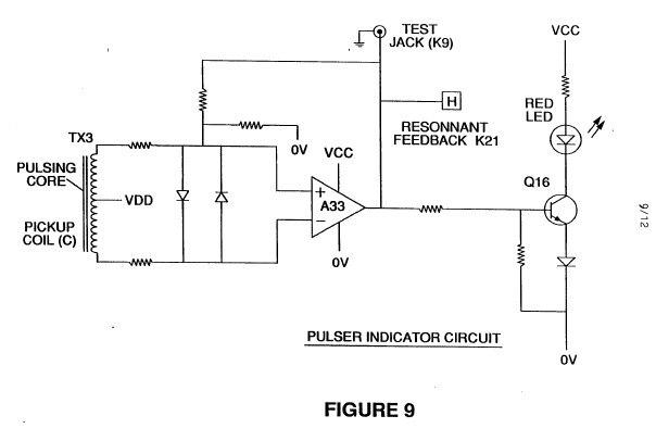

Here you see the diagrams i would like to put the delay between the H from pulse indicator circuit and H on the Phase lock circuit.

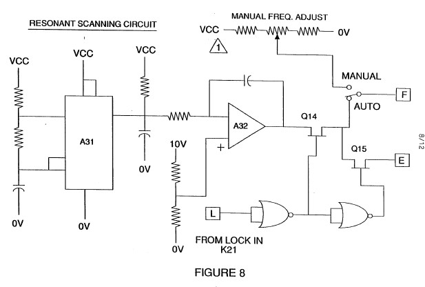

There are 3 dividers (4017) divide by 10 so i have 1hz to 100hz, 100hz to 1000, and 1000 to 10Khz ranges. The Resonant scanning circuit sends a 30hz sine wave like from 2v to 4v on pin 9 (F) and when it locks the logic gates stop the sine wave to let it remain in lock. Its working and locking at 1,8khz. I'm not sure its absolutely necessary the delay line but thinking about what happen there i think is a important parameter to adjust. Using the 1° comparator you can make it to lock far from the (center frequency 90°) to have a different phase. The 2° comparator lock at 0°.
