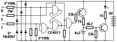

I'm searching for design schematics for a phase rotation meter. I hook up a lot of conveyor motors ranging from 120V to 480V. Does anyone know where I could get the schematics for this device? Thanks for any help you could give me.

I use this circuit.
The pulse width out of Sebi's circuit is twice as wide when one of the phases is reversed, so it appears that this is a circuit to tell when one phase is reversed, not a right - left rotation indicator.
