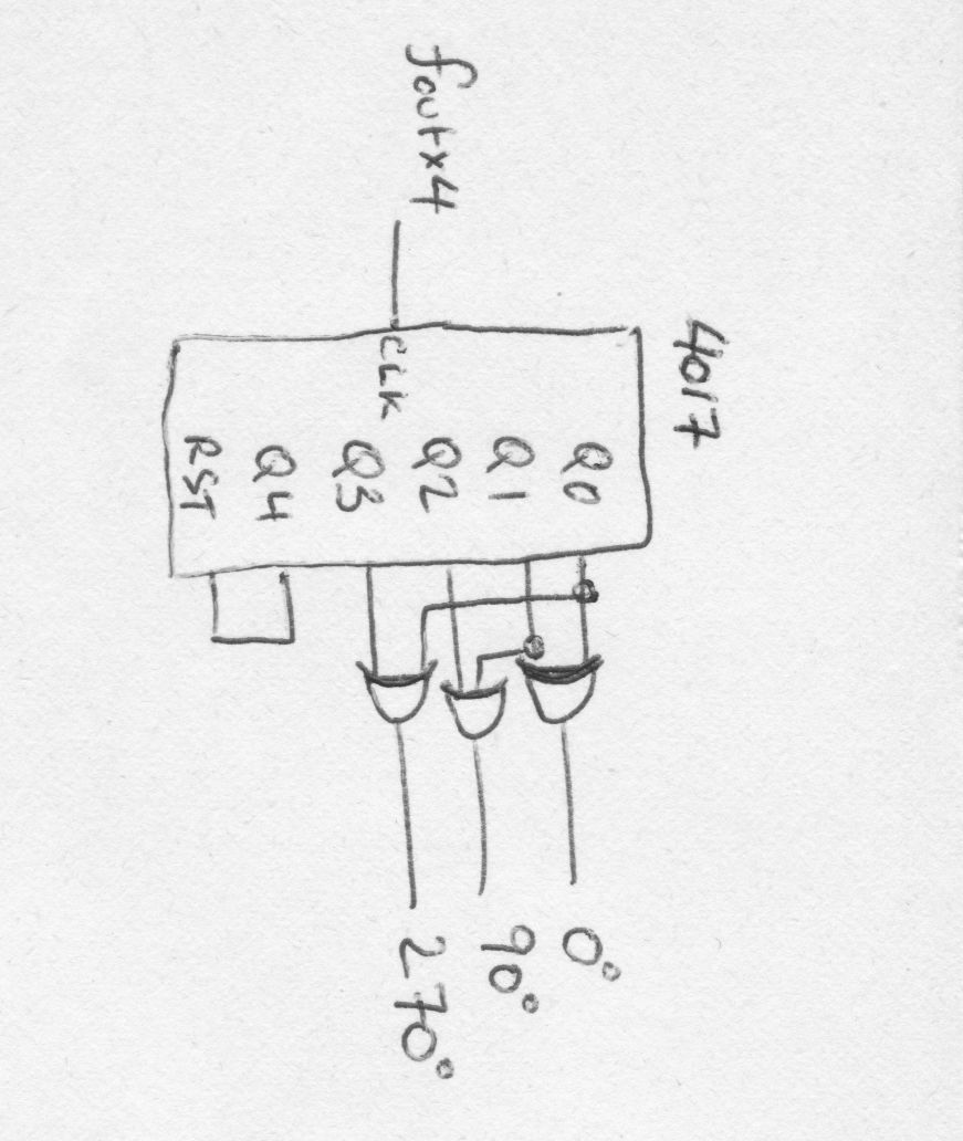

Perhaps an oscillator at 4x the desired frequency fed into a 4017 johnson counter with a few or gates tacked onto the output (see attached)?
EDIT: if you don't want to use OR gates, you can replace them with a couple of diodes & a resistor each..

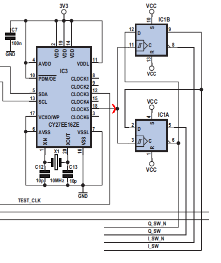

quadrature carrier supplies are derived using 74HC(AC)74 . It is true that the input would be at 4X
a diagram is attached courtesy Elektor magazine, thanks to the author Burkhard Kainka. Published in https://www.elektor.com/magazines/2007/may/software-defined-radio.91527.lynkx May 2007 issue (elektor software defined radio), the entire article is free for download for the members who register .

I meant "4047" not 4017...

if the frequency is Higher than 8 or 10MHz, i fear 40xx series wont be suitable and you have to resort to 74HC or 74AC versions,
Phil Ric's SDR TX appears interesting and you can clearly see that he used 74AC 74.

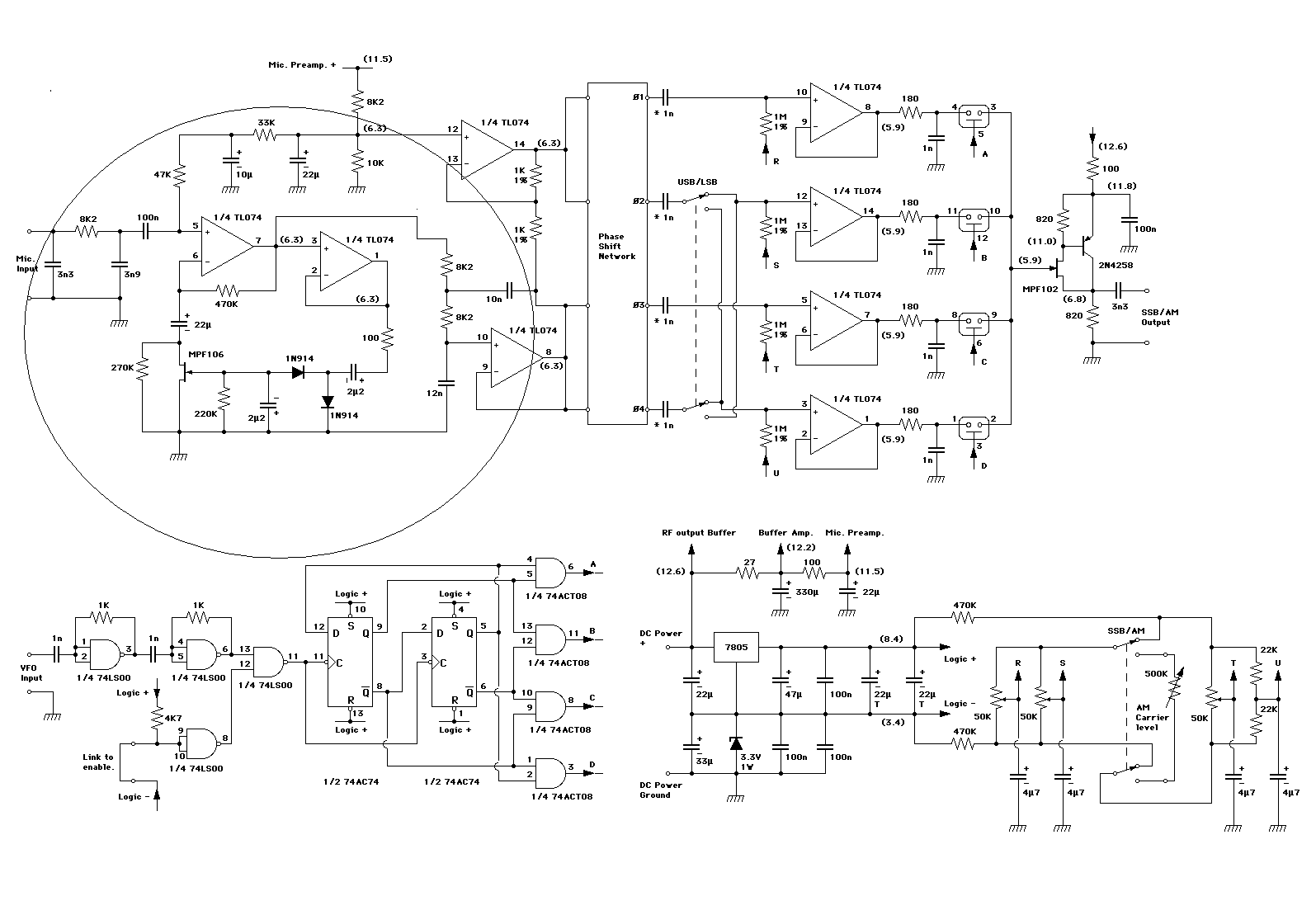

Please can you guys help me out to find out the functioning of the section I showed by a circle?
Is it an audio limiter? If so how it does work?

i suppose that it is AGC pre amplifier for the MIC input and even includes necessary pre empasis.The output of second op amp section is detected and the resultant DC varies the impedance of the FET. The FET in parallel to 270K, moderates its value and in turn the gain is automated.
Are you meaning it is an audio gain controller having pre emphasis? But as I now new electret mikes do not need pre emphasis, Right? Maybe Audioguru knows more about that? The main question is why they needed to use pre emphasis on that circuit? Due to mike or something else?
