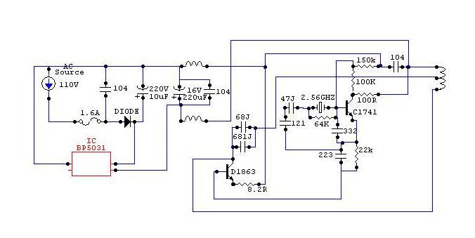

hi friends,
today i had a wireless phone for repair and its handphone have a cordless
power circuit, it can be charged like a primary and secondary transformer
and since it use from high frequency system rather than that normal 50 or 60Hz transformers it must be smaller than that common transfers, but after taking the hand phone apart i saw that there is a very thin board with less than 15 number of coil and without any iron or Ferrite,
the freq maker(oscillator) for the primary has one transistor and a few other components,
it would be very ok if some could suggest any circuit for these nice smal transducers,
how know how many freq the oscillator produce in these devices?
do you think if i make a coil as secondary with different numbers then it can produce power without any other component?(the original secondary can produce more than 8V)
i tested the primary with an only 15 number of wire as a coil (as secondary) and could lighten a 6V lamp,
that is good and now i need for a circuit for primary(as an oscillator,ok?)
but i dont know what kind of circuit is ok?!
i have no info about primary coil freq and voltage( the primary is a 3 wired coil that has the third wire at center).
i can not to measure the primary voltage with a volt meter, it seems it produces a squre wave not a sinus wave,
i am wondered why there is no info or circuit about that transformer in the net because its structure seems to be simple(there is less than 20 components on the primary),
i dont know, perhaps my key words was not so right :roll:

u have said that the primary side has only few components . tried reading the part number of the transistor? is that the driver for the primary ? . if both ans is yes. then u can find the max current in the primary. , further draw the ckt dia and post , so that others can have a look .

ok, here is the circuit, it has 2 transistor not one, an IC for reducing the voltage, i think to 12V but i am not sure.
it has a 2.6Ghz crystal sso it might to oscillate near 26 000 000 000 time per second, i think i am wrong becuse i dont know any transistor the could make oscillate so high :shock: ?! beside i never seen a crystal so high :shock:
what is your idea? who can explain the circuit?
i can not understand why there is a 2.56GHz crystal while 2 transistors can not oscillate more than 250MHz? really one is 100MHz and the other is 250MHz!

It's probably very simple, it's NOT a 2.56GHz crystal, only a 2.56MHz one. As you already know, you don't get crystals that high.
However, the circuit is so badly drawn, and completely confusing to look at, that's it's hard to understand - draw it out properly and repost it!.

sorry Nigel, the circuit is drawn with circuit maker5 and i was not able to save it because the software is a demo version, so now i have a pic from it and can not proper it
if you or othere guys could say me if the circuit generates a square wave or a sine wave and why there is a 3 wire coil and if i can use from 2 wire coil , then i'll try to build one using another circuit.
