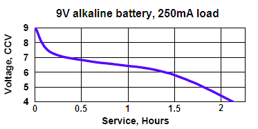

OK I just decided to build a 9 volt battery charger for my mp3. Using a 5v regulator and a usb cord and of course a 9v battery. Then I put it into a hobby box(Think that is what it is called).
Anyways, I am thinking of selling some more to my friends. However, I think it would be cooler if I could make a rechargable batterypack. How could I make it recharge when connected to a usb port of a computer.
Go to the website of a battery manufacturer like Energizer or Duracell. Then look at the datasheet for an alkaline 9V battery. Its voltage drops to 6.5V (when an ordinary 5V regulator fails to regulate) in about 50 minutes with a load current of only 250mA. You need more time and more current so a 9V battery is much too small.
A rechargeable Ni-MH "9V" battery is actually 8.2V and drops to 6.5V in about 20 minutes with a load current of 250mA.
Doesn't your MP3 player already have a rechargeable battery and a charger?
So in other words, any 9v battery I get will only be good for 50 minutes?
And yes it does but its usb based for cpus. It has radio on it and radio uses alot of energy on some stations. So I am making a battery pack.
