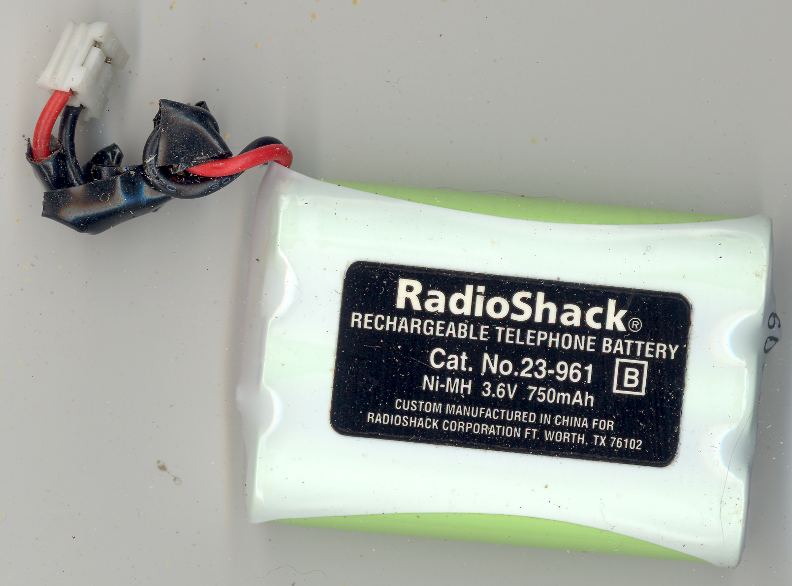

I need to replace my phone battery. RS wants a bit of money for these. They appear to be three AAA batteries.
How could I just make up my own three pack?
By buying three batteries the same size - if you can find them - if they are AAA size, then no problem. Simply solder the batteries together and apply heat shrink, or if you can't source that, then insulating tape.
Or just buy a ready built pack, which are freely available at low cost - just don't buy from Radio Shack.
Just looking for guidance. Have not used this phone for a while and it is quite old.
I opened the pack and they are definitely AAA size wired in series.
For my phone, I had to change the polarity of the RS pack.
So I just get three AAA 1.5v Ni-MH batteries and wire them in series? Do they have to be NI-MH?
Best to Use Ni-Mh as that's what the existing ones are, in any case Ni-Cd would probably be rare these days.
Each cell is a 1.2 volt NiMh battery and the 3 cells in series are 3.6 volts. The battery charge/maintain system is designed for that voltage and battery type. Years ago, before the demise of Radio Shack locally those packs were not very expensive. I used a few and like mentioned, had to reverse the polarity of my connectors. That said using a simple Google of "3.6 Volt NiMh Phone batteries Amazon" gets me a few dozen hits with most in the $5.00 to $7.00 range which I see as cheap and easier then building a pack and needing to solder to batteries which are normally tied using a metal strip and small spot welds. Considering price I would just buy rather than build.

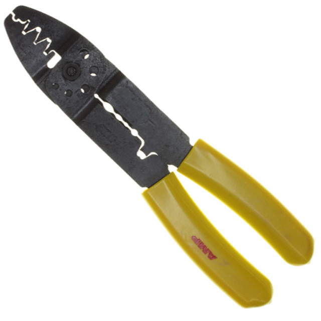

I think these https://www.hozan.co.jp/E/catalog/Crimpers/P-706.html are the crimpers you want. The TE connectivity ones were like $20.00 back in the 1980's .
It' the AMP service tool II. Here's the specs. https://www.te.com/commerce/Documen...6202&DocType=Customer+Drawing&DocLang=English Lots of distrbuters have the right part number, BUT the WRONG picture. BE CAREFUL.
This
696202-1/crimp-tool-hand-open-closed-barrel/dp/22C6015?CMP=AFC-ECIA
is not
**broken link removed**696202-1/A30574-ND/440285
Has the same part number, but the picture is wrong. I've tried many times to correct it. So. Maybe Newark/Farnell is not the place to buy from if you expect the data to be correct.
