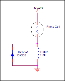

Is it possible to use a photo diode and nc reed switch to turn off a 6 volt dc battery pack?
I have a windmill with two 6 volt lights and 2 reed switches alternating the lights. I want to turn off the battery pack in the daytime.

OK, now if we just want to turn something on or off based on daylight a simple and small photocell circuit will do that. There are a number of ways to go about it. Using a simple comparator circuit like those found here would be one way. Scroll down to the Photo Cell circuits on the linked page.
Another option even simpler that I have used is just a LDR photocell in series with a small relay. The relay being capable of switching a few amps load. This uses a NSL-5910 Silonex Photo Cell and a small relay. Matter of fact I mentioned it in this thread. The relay was one of these, a 2BC-1B-107D. There are other relays that would work.

The relay I mentioned was just a 300 ohm 23 mA coil relay. Just about any relay designed with about a 5 volt coil should work. While the hermetically sealed can relays are nice, they do carry a hefty price tag. If you want one of the one I mentioned and can get the photo cell I mentioned I'll send you one. I have several slightly used that I'll never use during my lifetime. It's yours free if you want it. Just PM me a mailing address.
Ron
Got your PM, no problem at all. Attached is how to set it up. I suggest the 1N4002 as shown. I explained the relay pinout in the PM I sent. Just drop me a PM when it gets there. If you want to change the sensitivity (Light / Dark) just add maybe a 100 ohm pot in series with everything or maybe a 1 K pot but first try it as drawn. I am tossing in the LDR also. Enjoy and have a nice holiday season.
