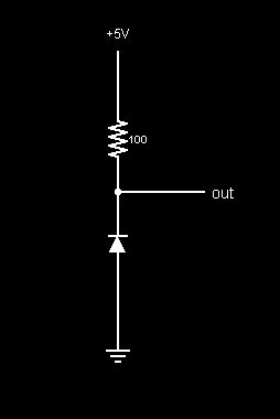

I put together the simple circuit in the attatchment. When I put a IR led in place of the diode, I get 4.4 to 4.6 V at out.
If I put a photodiode there, I get an output all the way from 0.1V to 4V! I didn't quite expect such a drastic change. This is usable voltage.
Could I just use the LM358 as a follower and use the output from there? The photodiode will be used to constantly detect small variation of distance at about 10cm. I plan on feeding the output from op-amp straight into a microcontroller. Anything I should be weary of?

Why is there an open input?
KISS was talking about the op amp output going to the negative rail when the input is open (or no signal), but that's not what happens.
Your purely resistive circuit puts the diode in photovoltaic mode and not a photocurrent mode. Some detectors have a better response using this mode.
Au contraire. That configuration, with the diode connected directly to the op amp summing junction and a resistive feedback, is a standard current mode input transimpedance amp. This circuit keeps the voltage across the detector at 0V so it is operating in the photocurrent mode.
When the photodiode is in the dark then it does not conduct, it is open. The (+) input of the opamp is grounded and it will try to make the (-) input also at ground through the feedback resistor by driving its output to ground.
With a 100 ohm resistor to +5V and a reversed diode to ground at the (-) input of an opamp and the (+) input grounded then the output of the opamp should be almost 0V, not +4.6V.
A reversed diode with no voltage across it generates a small voltage and current.
A reversed diode biased by a high value resistor leaks a small current. But since your resistor is only 100 ohms then the diode does nothing.
