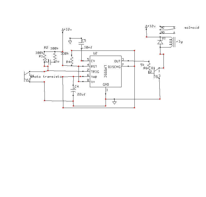

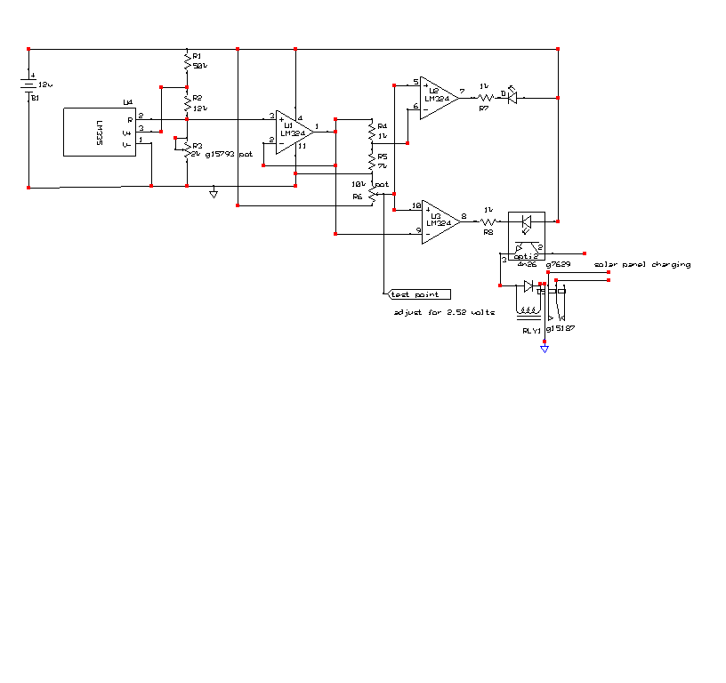

battery montor and one shot
use the one shot (5 seconds) to turn on the solenoid.

the battery monitor is a little overkill but very accurate.

MrDEB, you might want to check the triggering portion of the 'one-shot'
photo transistor gets light and trigger input goes low
is there something I missed?
That's what I thought. Won't the trigger input be pulled low all day though (and not actually provide a timed pulse out)?
one the trigger impulse goes low the 555 only outputs one pulse.
it triggers on a low going pulse if I recall.
the link has lots of circuit ideas (knowledge)
True, the output will output a single pulse, having a minimum period set by RC; but if the trigger input is held down for longer than 1.1RC, the output will be high for as long as the trigger is held low.
The output is _set_ high when the trigger is low, and _reset_ low when the threshold is high; trigger pin has precedence over the threshold pin however. Neither threshold or trigger pins are edge-triggered (both are level triggered).
