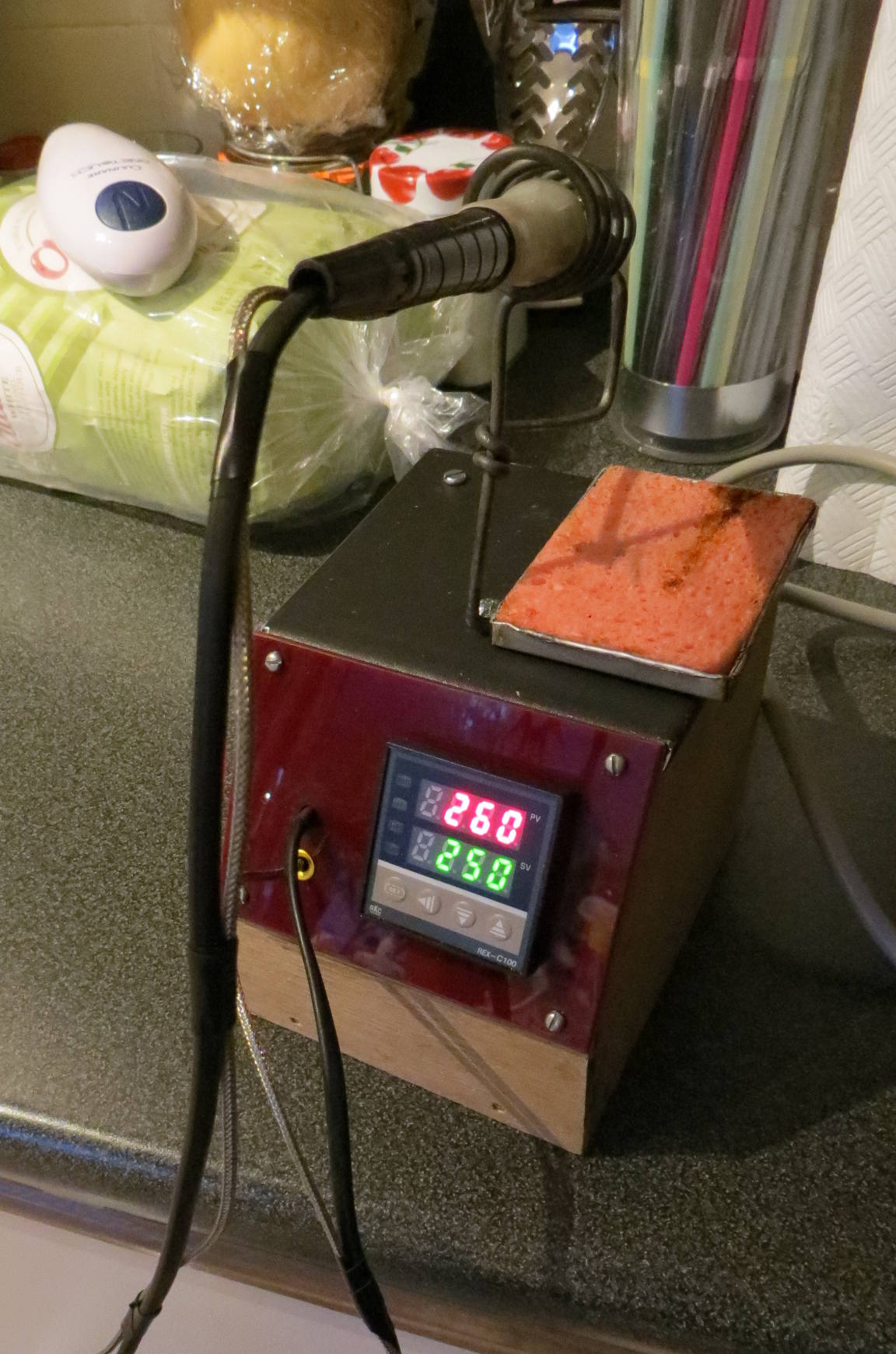

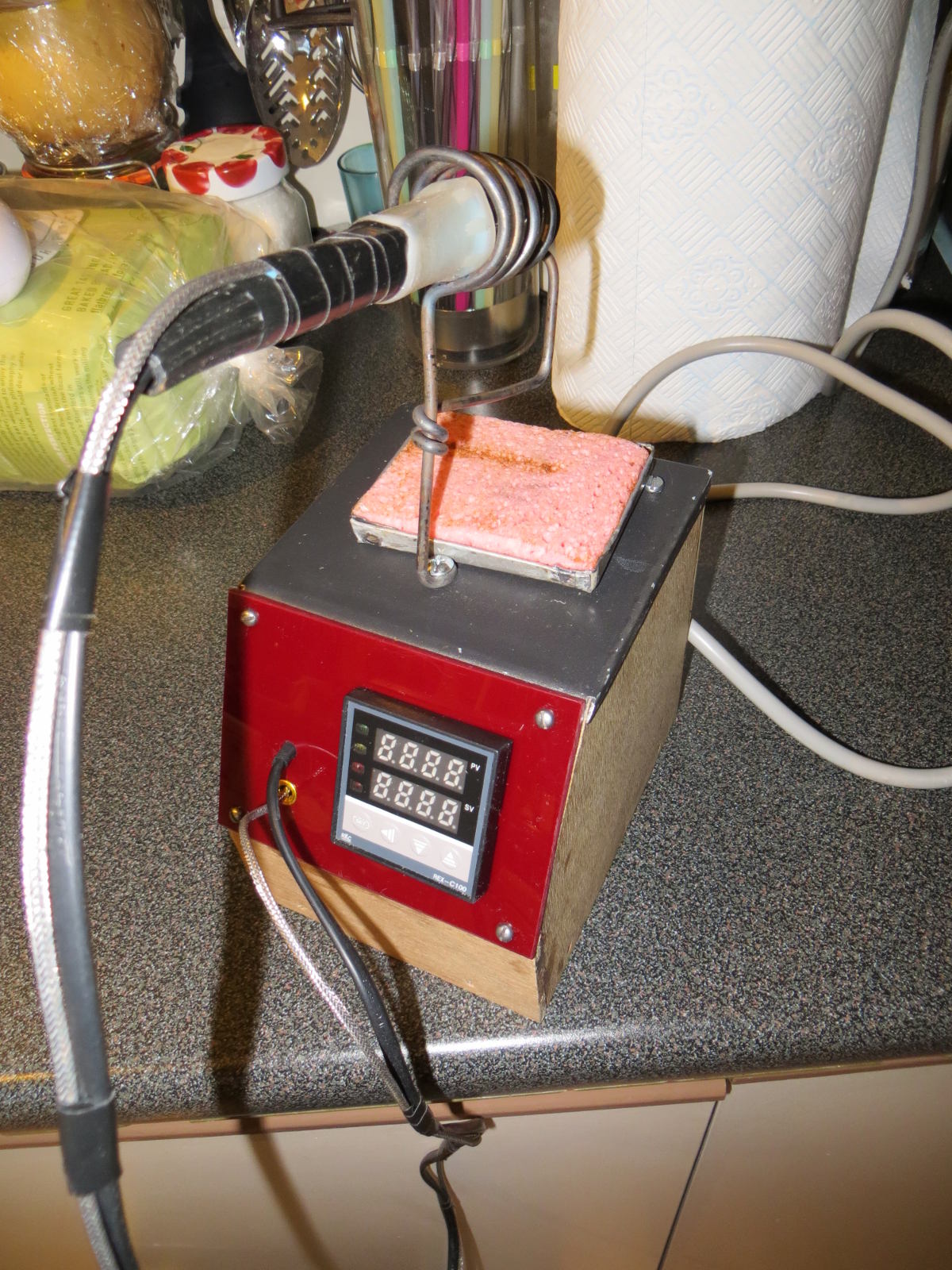

I have spent the last two days in the shed, mostly making the case for my home brew soldering station. The base is chipboard, the sides are plywood, the top is steel, the back panel is hardboard, the front panel is some plastic that I salvaged from a discarded shop sign about 12 years ago. Finally found a use for it! The stand on top is made from wire I got from a divan bed base. Tough tensile stuff, had to use blowlamp to bend it around...
Notice the sponge tray swivels out. This isn't ingenious design, it's completely forgetting to include it and having to find a way to make it fit! Worked out ok though. If I'd actually thought the sponge tray design through it would have been rather better :/
Inside the box is the pid controller and an isolation transformer which came from an old shaver socket.

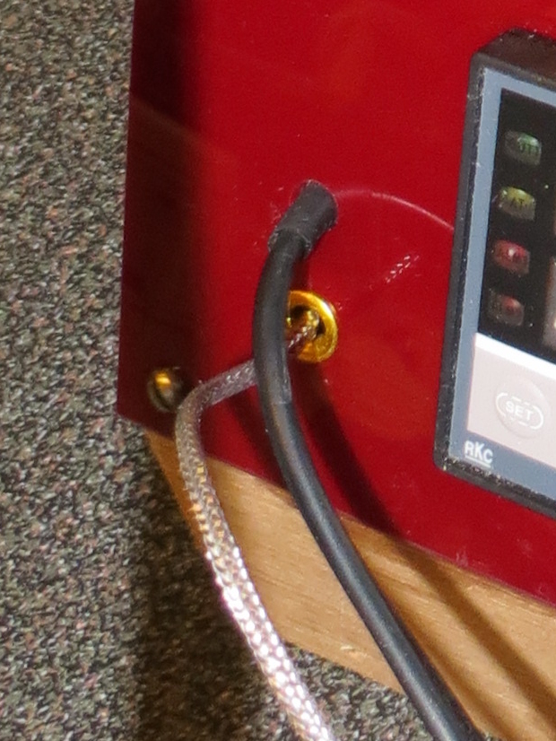

The brass coloured eyelet is the sort you use for clothing. I put a rubber sleeve on the soldering iron's cable to give a bit of strain relief. At the back is an IEC mains socket I pulled from something a long time ago...

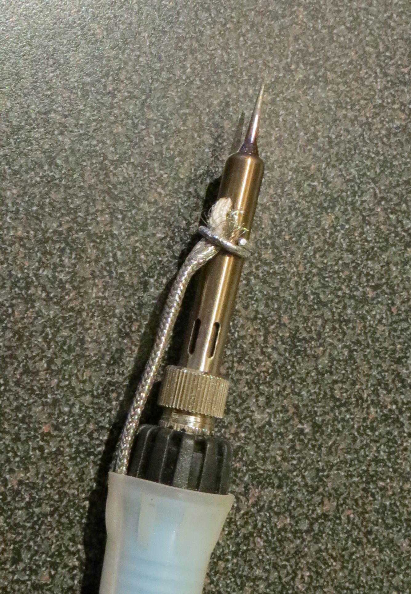

The thermocouple is shielded, and came with a metal "button" and nut on the end. I carefully filed the edges of where the button was crimped on so I could split it open and remove it, revealing the twisted wires inside. I trimmed back the shield a little bit, made a little oval hole in the soldering iron's sleeve and poked the tc end in. Since I had to take it apart a couple of times it got harder to reassemble due to the insulation fraying... The tc is squashed up with the bit at the end of the sleeve.
The metal ring round the barrel of the iron is the stem of a blind rivet I bent round to hold the tc wire in place. Ok I could have made something nicer but wanted to try it out soon!
The iron's handle is actually light blue - that's black tape around it. I wanted to thread the tc wire up inside but there's too much to go wrong by doing that.

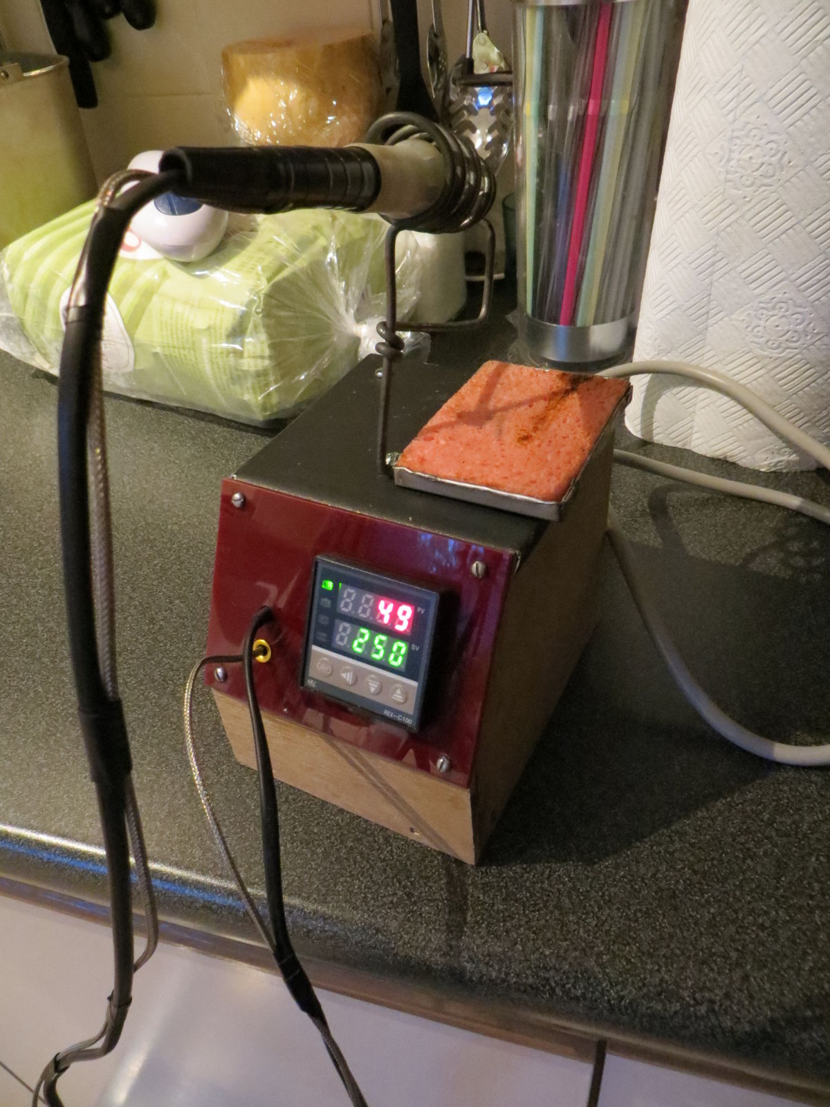

Temperature appears accurate - only 2 or 3 degrees different from the reading on my multimeter - which I recalibrated myself last year so is probably suspect anyway (but better than it would have been...) Solder just melts when it's set to 250. There's some overshoot - I haven't set up the controller yet, so expect to improve that. I tried setting the controller to 400 to see if the iron would get that hot, and it does - so I don't know what it would get up to without the controller.
