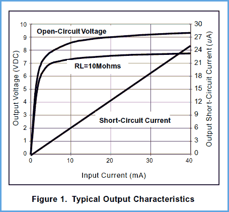

When the gate is charging up, current reduces and output voltage increase to 9V, as in image below. Good for saturate the MOSFET, if time is not of concern.

true but I looked at the the datasheet and you are looking at 10s to 100s of us to switch, this means a FET might be in its active region for an extended period of time, the could be bad new if you are switching either significant amps or significant volt or worse both
Of course we all know that it is "repetitive" slow switching pass the active zone which generates high dissipation and heat that kills the MOSFET or IGBT.
From the data sheet, a MOSFET with 1000pF gate capacitance takes 6mS to turn ON. If that speed kills the MOSFET, one way is to use several drivers in parallel to increase the gate drive current output and shorten the turn ON time.
The device is a not a magic solution for all applications but comes in handy in some special cases.
