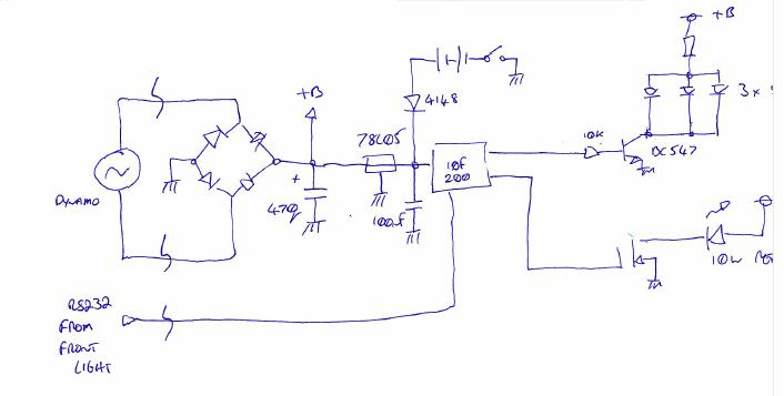

OK so your gonna ask for schem, heres a naff hand drawn one.
The rs 232 is used to tell the micro which led to flash and to sync the front and rear, the dynamo isnt powerfull enough to flash both at once, and they do not have current limit resistors and run at diffo voltages.
I think changing to a PIC that has brownout handling would be a good idea!
Re your circuit, if you change from the LM7805 5v regulator to a low-dropout type, your system will reach 5v whenever the input is greater than 5.1v. At the moment with the 7805 it only reached 5v when the dynamo is making more than about 7.8v! I bet that difference between 5.1v to 7.8v is right in the critical pedaling zone too where you have to start pedalling significantly harder to get 7.8v... ;)
Or alternatively, power the PIC from the two AA cells but make them rechargeable, and change the circuit so the dynamo keeps the battery charged. You can even get the PIC to handle recharging or at least part of the process. Again, going to a better featured 8-pin PIC like a 12F675 or 12F684 (Ithink?) will allow better performance especially if you want some battery charging handling.
A low dropout reg good idea, the dynamo produces 9v at walking speed but still a low dropout reg might be better, or for the amount of juice the pic pulls maybe a shunt reg with a zener and resistor, the leds are buffered with a tranny.

Since the last post I had a rethink combined with you peoples comments, why do I need the 'f200 powered by dynamo and batteries, and why does the 'f200 in the rear light need to switch the 10w rear light with a fet?, it doesnt.
With some minor code mods I now have a 2 x aa led flasher using the 'f200, and theres a simple level shifter tranny from the 10w red led to the pic, when the dynamo powered rear 10w led flashes the 'f200 shuts down flashing the smaller stand still leds, I just had to add a delay so that the pic doesnt start flashing the stand light leds inbetween 10w red led flashes, the the 'f200 is only powered by batteries, which if flat dont stop the dynamo working.
No reset issues, no 78l05, no fet, no serial and single core cable from the front.

Incidently I thoght I'd do a little work to see if the 'f200 would work on my system before giving up and going to another chip with brown out protection, and I did get it to work well, the 78l05 seems to be the issue, not sure whats going on exactly but I replaced the reg with a 1k/4v7 zener and a 100u cap and it works great.
The hub dynamo appears as a current source maye theres a wierd oscilation thing going on, cant be bothered holding the front wheel up spinning it and looking at the 'scope any longer.

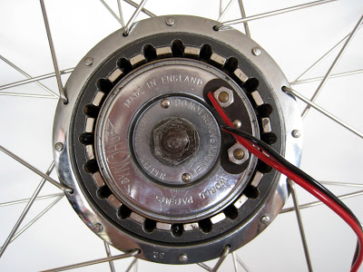

When I started this project I had an old dynohub (from my childhood), the magnets field strength has like my eyesight gone, however I found a couple of sites where they use these as wind power generators and a couple of guys have re-magneted them with neo magnets heres a pic, one thing I never understood is sturmey the manufac say that as soon as you pull the magnet from the housing it loses its magnetism and doesnt come back, didnt know alnico did that, but neo's wont, the o/p goes up by 3 times with this mod.
