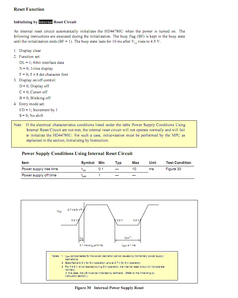

Presumably adjusting the contrast alters the contrast of the squares?, from nothing at all, to all black.
This usually means the display isn't getting initialised, so check the connections are correct, and check the code is correct. Are you building it on my veroboard layouts, or in some different way?.
Thanks for fast respons nigel - you are a merit to the electronics world!
Yes i have full adjustment of the contrast.
i am using wire wrap and euro card for devlopment.
Problems I've heard of people having are things like connecting pins to the wrong points, not actually connecting one or more pins, and accidently joining two pins together.
The PIC not running at all would cause it of course as well, can you scope the pins to make sure something is happening?.
Some HD44780 compatible controllers require a slightly different 4-bit interface initialization procedure like the one described here; Brief overview about Hitachi HD44780 LCD controller.
The 4-bit procedure requires specific 4-bit nibble data written at specific intervals to "reset" the controller before switching the controller into 4-bit interface mode. Here's an example that includes the procedure but it's written for a 16F690 with LCD D4..D7 on RC0..RC3, LCD RS on RC4, and LCD E on RC7;

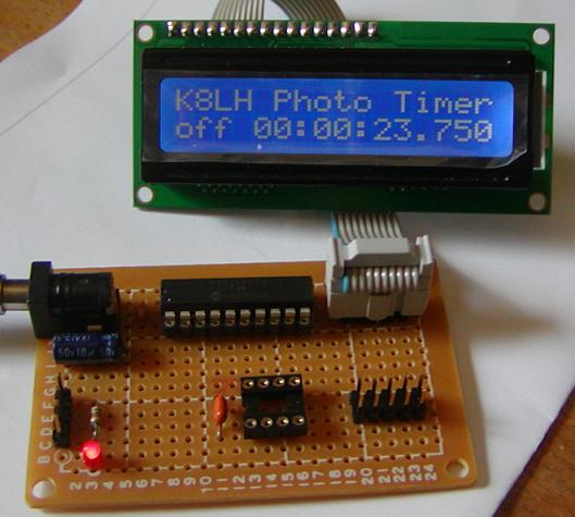

hi Nigel,
I have found that if the power supply does not meet the rise times expected for the LCD it will not internally reset.
So in many cases where the OP gets this 'failure to auto reset' it could be related to the way he is powering the PIC/LCD.
If the users power supply has 'large value ' capacitors on the output of a regulator this can also cause slower +5v rise times which cause a reset fail.
My advice to users who get LCD initialising problems, would be to state in their posts how the PIC/LCD is being powered.
Attached are some clips from the Hitachi manual.
Hi all
Thanks very much for your help
It appears that this may be a common problem erienced by others using nigels software, i have seen others on forums and this forum experiencing similar issues.
I am using a lm7805ct with a 33uf capaitor on incomming side and a 1uf cap on out site, unfortunatley i cannot attach anything for some reason at the moment but here is a link to the data sheet,
https://www.electro-tech-online.com/custompdfs/2010/04/0900766b80d25b92.pdf
(Figure 7)
Perhaps someone could show a way of using or modifying nigels software showing or explaining how an initilisation is carried out in the software.
Thanks for all your help.
