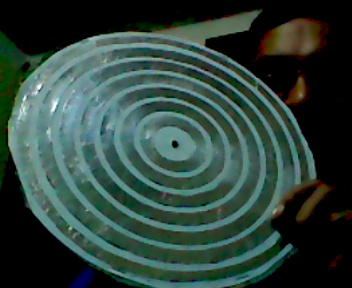

i also want to make a rotating led display...
i hab planned to do it in a different way, i hab made a circular track with 7channel in it to get supply to the LED. i hab attached a foto of it...
I hab understood about the refrence point which we have to use.. what i dont understand is what time delay we need between the successive position of rotating LED i mean what is the appropriate speed of motor.. can any one tell me how fast moving object our brain can detect..
I hab read an article at Wikipedia.com and found that the presistance of vision is 25th of a second....
i hab planned to use AT89s51 microcontroller. M not going to place microcontroller on the rotating disc rather it i'll be placed separate.......
can any one suggest me some idea about this topic..
