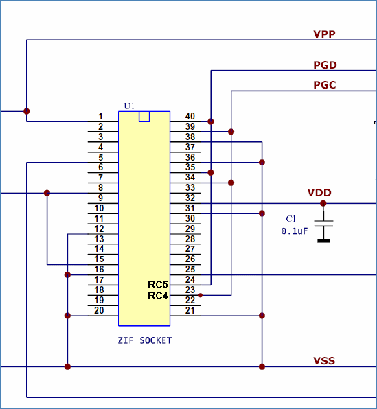

Hi. I am working on a board which has been functioning fine using an ICD-2 to program my 18F4550 40-pin DIP, through the supplied header. Now, I am attempting to transfer this circuit to a PCB, using a 44-pin 44-pin TQFP chip (flat square surface-mount chip, but not the socket type). In this guise, the 'only' changes made to the design are the new connections between the PGC, PGD and MCLR pins, to the new programming connector. In this form, my board will not connect, and I get a warning "ICDWarn0020: Invalid target device id (expected=0x90, read=0x0)".
I am powering the board through the ICD-2, and there are no warnings about voltage levels. Any ideas? Apart from continuity testing, and voltage probes (which have all suggested a good board..).

Anyway, the icd2 is connected to an AC162049 header board. I then used the flying leads to connect to a custom USB cable which plugs into the mini-usb-b port on my board. Vpp is connected to MCLR(pin18) , +5V is connected to +5V(pin7 + 28.), GND is connected to GND(pin 6 + 29), PGD is connected to PGD(pin17), and PGC is connected to PGC(pin 16).
I have enclosed the schematic as a .pdf.

ok, its been solved...
It turns out that the lines going from RB7 and RB6 to RC5 and RC4 were causing problems. Essentially RC5 and RC4 were causing the query signal from the icd2 to be degraded so much that the chip wouldnt detect it. Temporarily split the line for programming and it detected it perfectly (well, i say perfectly... it turns out the 4550 is actually a dead chip after all, but it worked with the 2550).

I'm glad you have the problem solved.
Since you have mentioned RC4 and RC5 connections with PGD and PGC messing up the ICD2 signals, I looked at the 40-pin ZIF socket connection to my programmer and can confirm that RC4 & RC5 do indeed connected together with PGD and PGC(used for programming the 16F PICs) and this have not caused any problem during programming a 18F4455 using ICD2.
But alas mine is a ICD2 Clone, not the real one.
