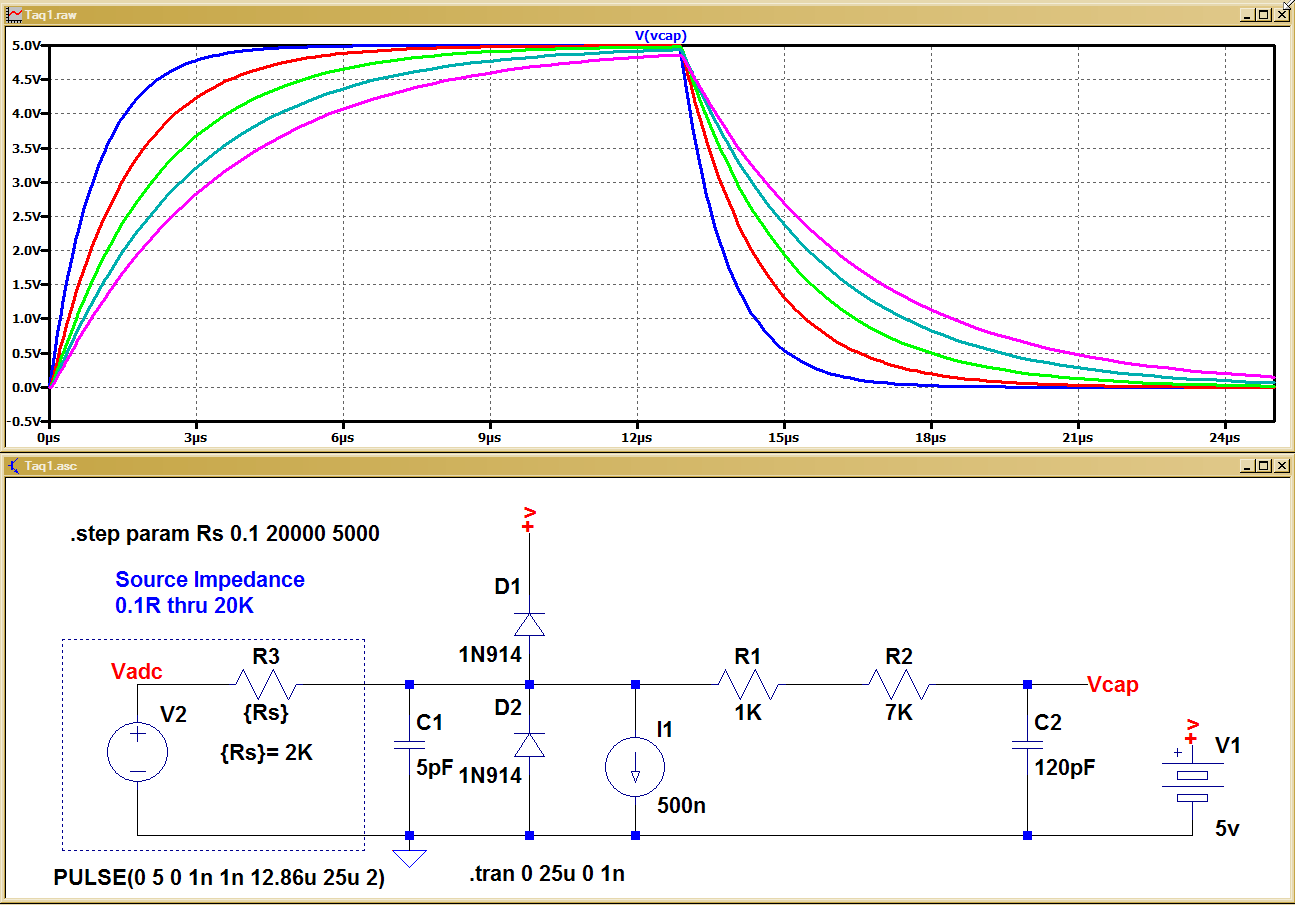

This is a simulation modelled on the PIC's ADC circuitry.
It shows the rise/fall times of the voltage on the internal 120pF cap, when changing the external source impedance.
